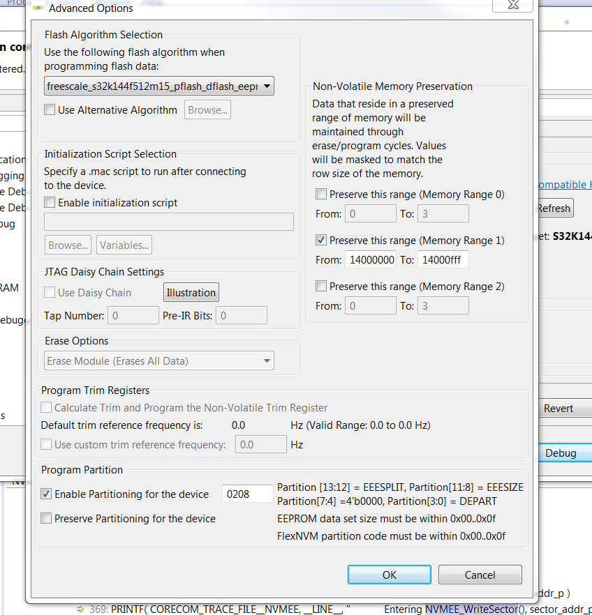

I'm having an issue with data written to flex Ram.
I can partition the device(S32K144) correctly and I write some 8 bytes at the top of the flex ram (0x14000_000)
Then I COMMENT OUT the statement which writes to the flex_ram and down load the code using the PE open SDA or multilink universal on S32K DESIGN STUDIO FOR ARM. When I look at memory at location (0x14000_000), it contains all FFFFFFs which is the erased state of the flex ram when used as EEPROM, please keep in mind that the partition still preserves but the data is lost.
In the debug configuration window under debugger tab there is advanced option button that lets you preserve the partition and some memory range(I guess they are there since the PE TOOL mass erases before it downloads), for memory range I put
0x14000_000 to 0x14000_FFF which is 4k however this does not do the trick .
Any help is appreciated.

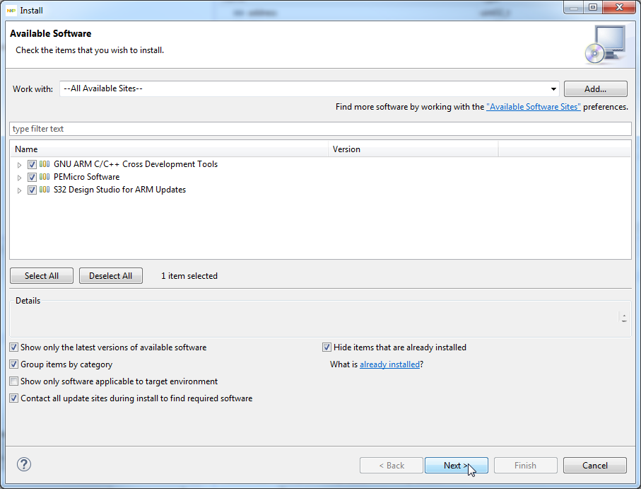

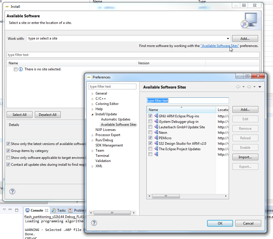

it looks like that you are using older version of PE Micro tool set. Please update the tools to latest version by clicking on Help -> Install New Software
Click on Available Software Sites and check PE Micro:
As a last step - select All Available Sites and proceed with update:
Hope it will fix the PE Micro debug issue.
Jiri

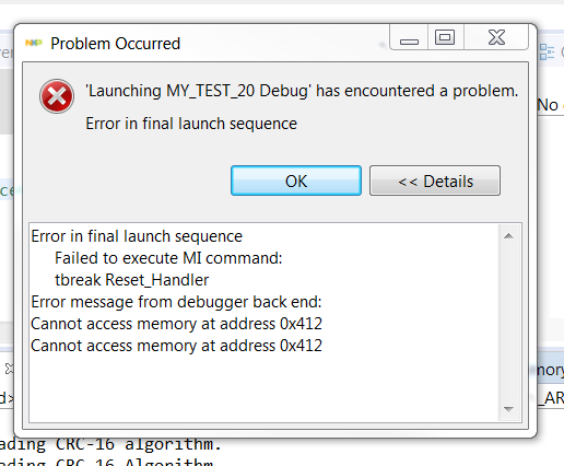

I followed your instructions to update the P&E . Unfortunately that did not resolve the issue. exact same thing happens.
This error message appears after flash failure.
Location 0x412 is in the beginning of the Reset_Handler.
Please note that if the box in Memory preservation field is unchecked , the down load and debug wok fine.
The location mentioned in problem report is not protected or secured.
Really don't know what is going on.

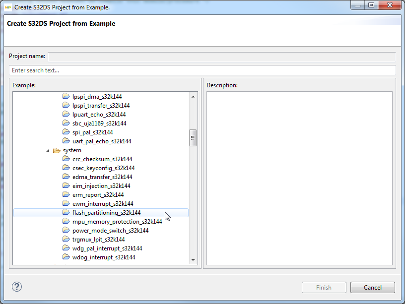

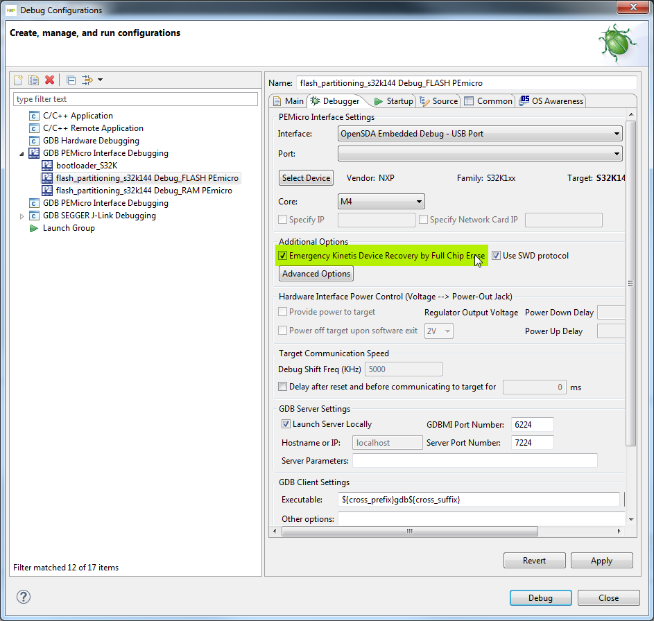

it is possible share your project? If not - can you test flash_partitioning_s32k144 example project? This project does almost the same stuff as yours - and for me is working without any issue when preserve memory is checked.
You can also try Kinetis emergency erase:
Jiri

I got over the issue ,which is not a %100 full proof but still let me debug on 32k design studio by configuring the tool as below:
which configure 64k of d flash as back up and 32k flex ram as NVRAM.
