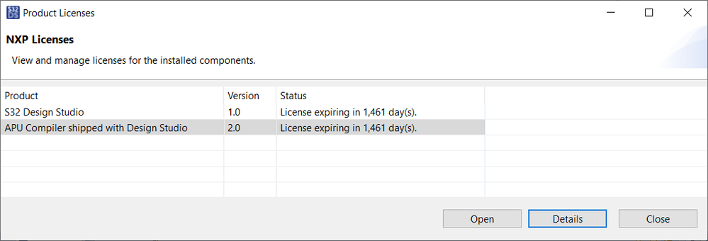

jorge_barrio
This is a screenshot with the active license at the moment.

mikedoidge
Hi Jorge,
Did you really install this to the S32 Design Studio v3.2 or was it v3.1? The Vision Extension Package for S32V2xx v.1.0.0 should be installed to S32 Design Studio v3.1. We have not updated it for v3.2 yet. The error you are seeing could be due to this incorrect combination.
Mike
