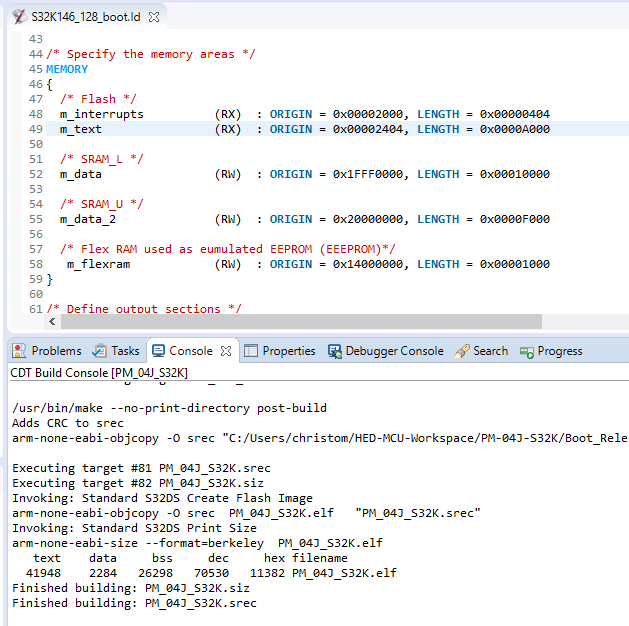

Using the default linker file for the S32k144 that the S32DS comes with, the linker fails to generate an error when the allowed size for the m_text is exceeded.  Looking at the linker file it doesn't directly put the data ROM into m_text but rather creates some variables and uses those.  This prevents the linker from generating an error when the assigned sized of m_text is exceeded.
In my case my linker for the m_text looks like this
m_text (RX) : ORIGIN = 0x00002404, LENGTH = 0x0000FBFC
I would expect that if anything stored in this section goes beyond 0x12000 the linker would generate an error.
If the .text section exceeds the size it triggers and error.
However these two sections also go into flash but do not trigger an error because they are not directly placed into m_text but rather use variables defined in the linker file (__DATA_ROM & __CODE_ROM)
.data : AT(__DATA_ROM)
.code : AT(__CODE_ROM)
How can I get the linker to properly trigger an error?

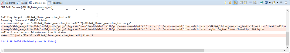

I'm not sure about your scenario. By default - when section size is exceeded linker error message is shown:
Can you share your project or .map file?
What's your size output from build console?

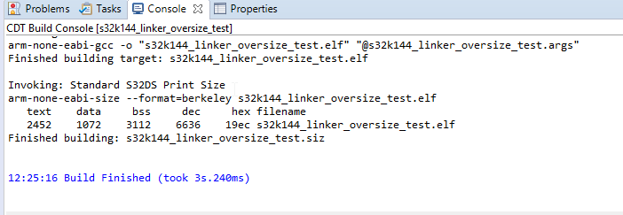

If I shrink the size of m_text enough I do get the error like you said
However if I make the size big enough for m_text to fit but not big enough for these sections it doesn't give an error
Notice if you add the text size to the data size it is 0xACC8 which is larger than I allowed the space to be
From the map file it goes past the allowed space (0x2404 + 0xA000 = 0xC404)
