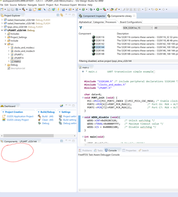

I opened this example LPUART_s32k144 in S32 Design Studio for Arm version 1.0 , there is no infomation for pin configuration listed in "components" menu shown here. Is this supported by processor expert? how can I do further graphic configuration here? Thanks.

it's a project where the SDK is not used. So, no components are visible. It looks like example from AN5413 - all these examples are bareboard projects.
By the way, I can see you use older version of S32DS. The latest one is 3.4:
https://www.nxp.com/design/software/development-software/s32-design-studio-ide/s32-design-studio-for...
And the latest SDK is RTM 4.0.2.
It's highly recommended to use the latest ones.
