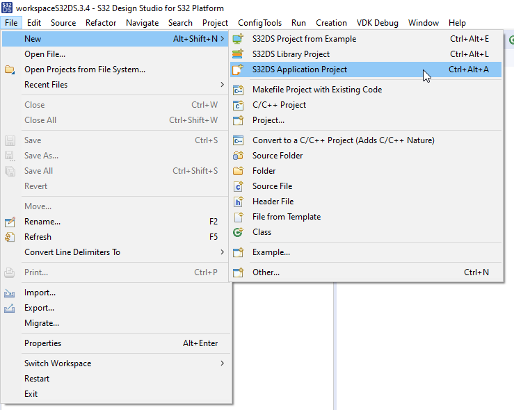

Hi Guys, I'm new to S32 Design Studio. I've just installed the latest S32 in Windows 10 and have downloaded and updated all the SDK's in the download section.
I'm just creating my first C\C++ and have typed in my project name.
Now S32 asks me Cross GCC Command and in the 2 text boxes
Cross compiler prefix:
Cross compiler path:
what do I type in to these 2 text boxes. I have no idea.
Please help so I can get my first project running on my PDX20.

instead of create new C/C++ project please select New -> S32DS Application Project:
This option fills all requested parameters for you.

Hi Jiri, thank you for that.
I chose what you said and in the processors list window my micro controller is not listed.
I'm using the PDX20 176pin LQFP. I know the MPC5645S is the same chip but there is no Family MPC564xS.
Which Family do I chose for my PDX20 chip?

S32DS doesn't support such old device. You need to download CodeWarrior - https://www.nxp.com/design/software/development-software/codewarrior-development-tools/codewarrior-l...
