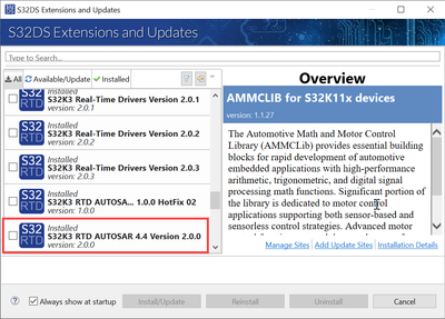

I am facing this issue that whenever I am trying to open .mex file it is showing this error:
-> Platform SDK_S32K3_2022_03 version not supported by current version of the tool
My current setup is as follows:
1.S32K Design Studio v3.4
2.SW32K3_S32DS_3.4.3_D2112
The mex file is of the firmware version v0.9.1  :
SW32K344_HVBMS-RD_Bring-up_Example_S32DS_0_9_1_D2303
directory :
->/HvBms400_Bring_up_examples/HvBms400_775_772_TPL_Bring_up/HVBMS-RD_Bring-up_example_S32DS.mex
1,721 Views
rushabhanadkar
The issue got solved by adding this zip file
SW32K3_RTD_4.4_2.0.0_DS_updatesite_D2204
Now I am able to open the HVBMS-RD_Bring-up_example_S32DS.mex file.

Hi @rushabhanadkar
Could you double-check if the SW32K3_RTD_4.4_2.0.0_D2203 is correctly installed in S32DS? To check this, go to S32DS Extension and Updates, and the software needs to say "Installed" as shown in the attached image.
