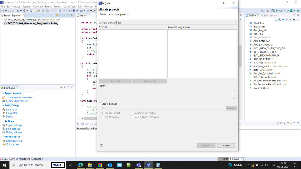

Hi NXP team,
From the NXP website, we obtained the BCC SW Driver Package for MC33771C and MC33772C.
We are trying to migrate the those example projects into S32 design studio for S32 platform (Version: 3.5).
We followed the migration procedure from the following link: https://community.nxp.com/t5/S32-Design-Studio-Knowledge-Base/Video-Migrating-S32K1-projects-from-S3... .
However, the code is not migrating correctly, and we are unable to determine why.
Please assist me in fixing this problem.

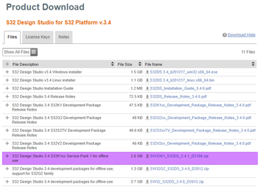

For the S32SDK S32K1XX RTM 4.0.2, you need to install a service pack, this can be downloaded from S32 Design Studio 3.4 S32K1xx Service Pack 1 > S32 Design Studio IDE >  S32 Design Studio for S32 Platform v.3.4.

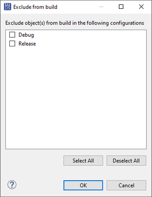

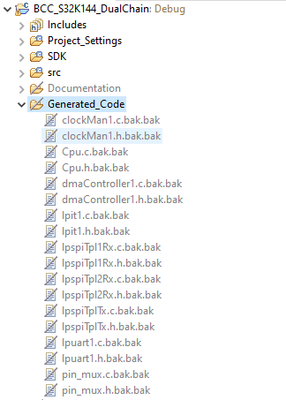

I reproduced the steps of the video and the problems I faced were related to libraries inclusion.  These libraries are located in the Generated_Code file. To solve this problem you need to Rename the ".c" and the ".h", you need to delete the ".bak" of each.
You also need to "Exclude from build" the Generated_Code file.
And need to include the file path at project properties.
B.R.

Following your advice, I installed S32DS v3.4.
However, as you can see in the attached image below, when I attempted to migrate the project into S32DS, no project names were displayed.

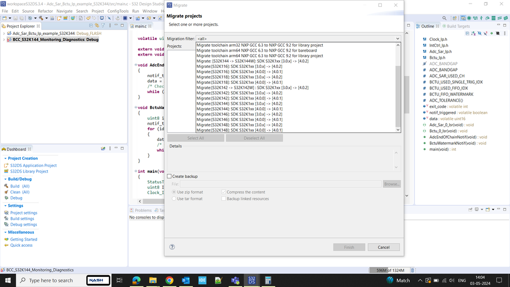

I can see several possibilities mentioned there after expanding the migration filter option. However, the files were associated with SDK S32K1xx 4.0.2 (see to the attached image below).

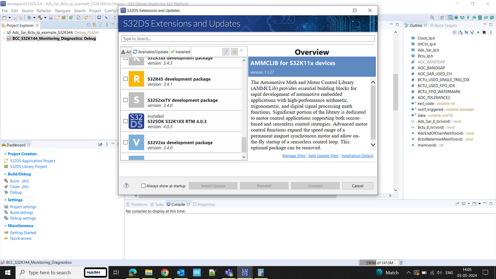

However, all I see in my IDE is SDK S32K1xx 4.0.3 (see attached image below). There is no SDK S32K1xx 4.0.2 listed here.
How can it be installed if SDK S32k1xx 4.0.2 is the only version that supports it?
Could you please help me to address this problem?

VaneB
Hi @Hareesh
6,309 次查看
Hareesh
Hi @VaneB ,
Thanks for the assistance; everything is operating smoothly now.
