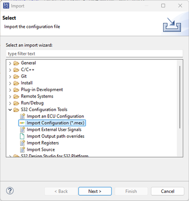

Are you using the same RTD version between S32DS instances? If not, the .mex configuration file cannot be opened directly.
You can try to import the configuration by:
1. Creating a new S32DS project for the new version you are trying to migrate.
2. Right-click on the Project name and select "Import" and "Import Configuration (.mex)".
3. Browse to the import file (.mex file of the previous version) and Select "Finish". After that, you can open "Peripheral configuration" to fix errors in the configuration, if any appear. You can choose to either merge the changes or import the config as new.
Otherwise, you must create a new .mex file from scratch and copy over the configuration from the previous project.
