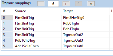

In MTRDEVKSBNK144_S32DS firmware,why TRGMUX output 2,TRGMUX output 3 and TRGMUX output 6 in Trigger MUX Control is used and how this works in this firmware?
as i also attached the firmware

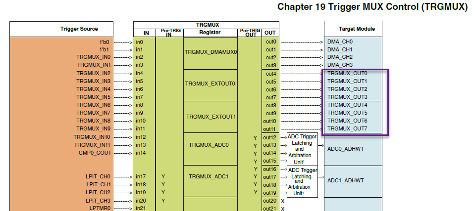

i looked in reference manual but i didn't find any description for TRGMUX output

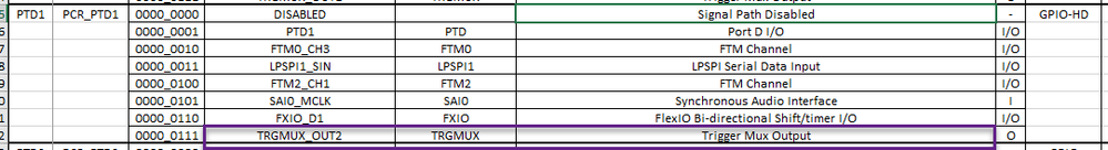

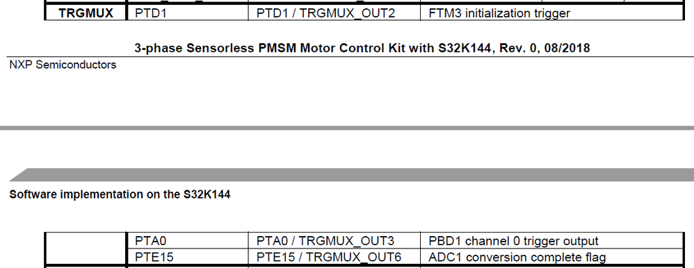

These three triggers FTM3 init, PBD1_ch0, ADC1 COCO are routed to PTD1, PTA0, PTE15 for debugging purposes only.
You can measure the control loop FTM -> PDB -> ADC on external pins.
The TRIGMUX_OUTn are pin functions that can be used as a target module of the TRIGMUX.
