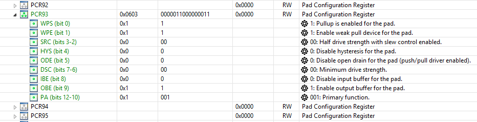

I have S32DS and controller with MPC5777C. I try to start SPI communication with external chip and got stopped at SPI clock generation. I cannot get to any clock signal on SCKA. What do I miss? I set Primary Function, output enabled, master enabled, pushed fifo and nothing on the clk output. Could anyone help? Maybe someone has done something similar?

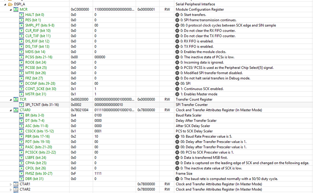

robertfromcummi
Martin,
I found some time today to make few experiments with SPI and it looks like clock signal is being generated. It was enough to clear the status bit TXRXS.  Now I need to find out how to make exact number of clock pulses ...but I will try to make it myself first.
Thank you for helping with it.
Robert

It is 416BGA and we have designed our own controller and I connected oscilloscope probe on the pin with CLK for spi. I checked if it is connected to right pin by forcing the change of state when in GPIO mode. I was able to change state of the output from low to high and back. It is GPIO 93 ...so it is PCR93 register. Of course when checking SPI I changed back to Primary Function by setting 1 in PA field.
This must be something small in configuration that I still miss ...below there is piece of C code that use for it. Maybe the sequence is not right?
Robert
void SPI0_Init(void)
PCR[93].B.PA = 1; //SCKA - Primary Function
PCR[94].B.PA = 1; //SINA - Primary Function
PCR[95].B.PA = 1; //SOUTA - Primary Function
PCR[96].B.PA = 0; //CS GPIO - Chip Select
GPDO[96].B.PDOn = 1; //CS - OUTPUT BUFFER TO ONE
/*Configured Master mode */
//SPI_0.MCR.R = 0x80030001;
//DSPI_A.MCR.R = 0x80030001;
MCR.B.HALT = 1; //Stop transfers
MCR.B.MSTR = 1; //Enables Master Mode
MCR.B.CONT_SCKE = 1; //Continuous clock
MCR.B.DCONF = 0; //SPI
MCR.B.FRZ = 0; //Do not freeze in debug
MCR.B.MTFE = 0; //Modified Transfer Format disabled
MCR.B.DIS_TXF = 0; //TX FIFO is enabled
MCR.B.DIS_RXF = 0; //RX FIFO is enabled
MCR.B.CLR_TXF = 1; //Clear TX fifo counter
MCR.B.CLR_RXF = 1; //Clear RX fifo counter
MCR.B.MDIS = 0; //Enable module clock
MCR.B.HALT = 0; //Start transfers
//SPI_0.MODE.CTAR[0].R = 0x78021004;
MODE.CTAR[0].B.FMSZ = 15; //number of bits to be transferred (FMSZ + 1)
/*Receive FIFO Drain Request enable*/
//SPI_0.RSER.B.RFDF_RE = 1;
RSER.B.RFDF_RE = 1;
/* Exit HALT mode: go from STOPPED to RUNNING state*/
//SPI_0.MCR.B.HALT = 0x0;
MCR.B.HALT = 0x0;
2,983 次查看
martin_kovar
Hi Robert,
by default, there is no clock on the pin while you do not transmit message. At first, set CONT_SCKE to 1 and then check, if there is the clock on the pin. If not, try to send some message and measure the clock during the transmitting.
If there will not be any clock, please write me back and we can check your GPIO settings.
Martin

robertfromcummi
Martin,
Thank you for helping. I set up CONT_SCKE and also made few experiments with different GPIO settings. Still could not get to clk signal. Interesting thing is that I see SPI_TCNT but always with value 2. Please look below on how the registers are set. GPIO is set as primary function which should be SPI and I checked OBE with 0 and with 1 too.
I like the bit fields but maybe I should not set up it by bits but rather write all bits at once ...maybe it is just problem with setting up the module. The view is from S32DS on Eclipse.
Once again thank you for help.
Robert

martin_kovar
your settings seems to be OK. Just to make sure, do you use EVB or your own design? If you use EVB, which pin do you measure the signal on?
Also, please write me back if you use package 416BGA or 516BGA.
Martin
