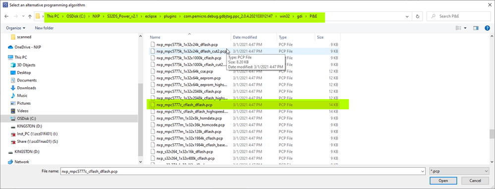

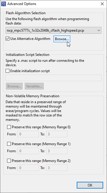

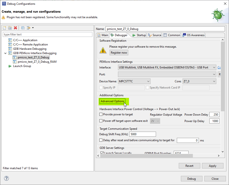

1,888 Views
jiri_kral
you can try to use different programming algorithm:
Also updating PE Micro plugin may help:
https://community.nxp.com/t5/S32-Design-Studio-Knowledge-Base/HOWTO-Install-update-from-3rd-party-ve...
