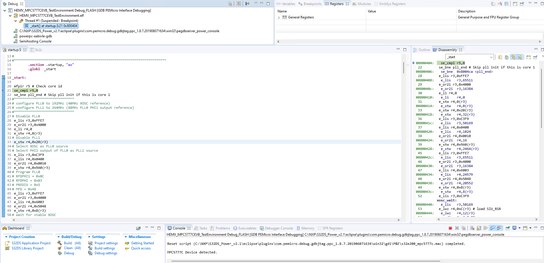

MatheusFranklin
Thanks for the reply, Stan!
The tutorial that you sent seems very promissing, however, when I followed the steps, I ended up with the same error as the picture I sent before. I am using the standard reset script and running code from flash. Do you have an ideia what could be causing this? I attatched the reset script below, just in case you need to analyze it.
Matheus

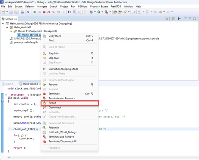

Julián_AragónM
Hi @MatheusFranklin,
While in the debug perspective, you can right-click the active thread and select "restart":
Julián

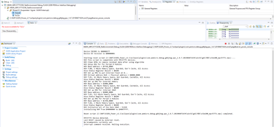

MatheusFranklin
Hello, @Julián_AragónM !
When I clicked on the "restart" button, I ended up with the following error:
I expected to see a scenario simmilar to when I click on the debbug button, like this (i.e., the execution stopped on the first code breakpoint):
Can you help me with that, please?
