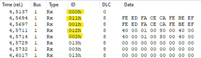

I then power-cycled my board and sent with a 3rd party CAN tool manually the following messages (500 kbit/s):
1) ID: 0x000, DLC: 0
2) ID: 0x011, DLC: 8, FE ED FA CE CA FE BE EF
And now I receive the echo from the MPC5775B: ID: 0x001, DLC: 8, FE ED FA CE CA FE BE EF
Therefore I conclude that the bootloader in general is running and the hardware including CAN transceiver etc. is working properly.

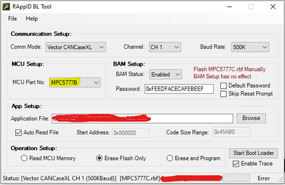

I think I am a step further! The RAppID BL Tool GUI comes with a file named "RAppidBL_MCU.rbm". In this file, I copied the line for MPC5777C and re-named it to MPC5775B. Then, I changed the parameter "BAM Type (Type of BAM implementation designated by a number)" from "0" to "1".
[MPC5777B]
RBF_Files\MPC5777C.rbf, 0x40000100, 0x4000, 115200, 115200, 1, 1, 0, 0
Now, I am able to select MPC5775B in the list of targets in the GUI:
And now, when I click "Start Boot Loader" it actually does do something:
So it does correctly begin with the AutoBaud-Rate negotiation and then following the "default password" and everything gets acknowledged by the MCU.
Just: after some time, it prompts an error that the communication was lost...

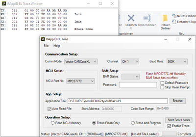

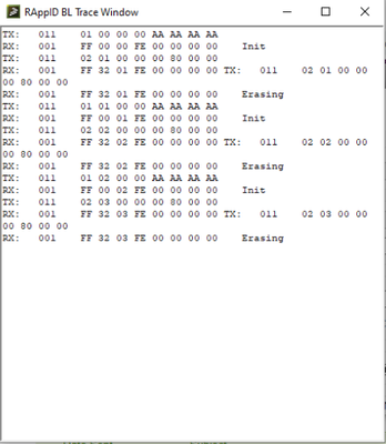

I repeated the experiment as follows:
1) instead of MPC5777C_S32DS_UART0_CAN0.rbf I now flashed the "original" MPC5777C.rbf which came directly with the RAppID BL Tool GUI.
2) the BOOTCFG of the microcontroller is now "jumpered" to [00].
Now, at least an erase operation seems to be working:

RappID Booloader for MPC57xx does not use BAM so please disable BAM Setup in Bootloader app. and set the boot pins to boot from internal flash (as you already indicated)

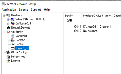

I assume you assigned Bootloader App to the physical Vector CAN channel in Vector Hardware Config (please see “2.9 Enabling Vector Hardware” in the user manual):
I noticed from the screenshots you are able to erase the flash so it seems there is no issue in CAN communication between RappID and your target board.
Are you able to dump a memory content using "read MCU memory" option e.g. (0x0080_0000-0x0080_FFFF)?
If you can dump and erase and there is an issue with programming only I suspect your s-record might overlap with booloader area (0x0000_0000 .. 0x0000_FFFF)

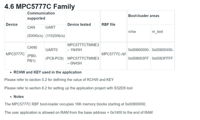

I see that you are trying to flash the bootloader area which is given below.
I'm sure that, the application should be placed in any other place than the bootloader area.
Also you can check the original topic below :
https://community.nxp.com/t5/S32-Design-Studio/Rappid-Bootloader-on-MPC5777C/td-p/1414182
Edit: I'm currently aware that you are trying to use 5777C .rbf, this should be a problem too in RapidBL pow.

fev_buergel
Hello Ege,
I am not quite sure if I understand you properly. Let me answer like this: I am sure that the bootloader is flashed onto the MCU (in the flash ROM). It must be there because it does reply to CAN frames which I manually send. There are only two devices connected to the CAN bus: my PC and the target board with the MPC5775B.
When I send the password CAN frame, then the bootloader replies by sending the echo (same content of the CAN frame, but different CAN ID).
What is not working is: use of the GUI (NXP RAppID BL Tool). I have the impression that it does not work, since the RAppID BL Tool does not: 1) send the "autobaud" frame and 2) does not send the appropriate password.
Both things together lead to the error "Loss communication...".
I tried to attach some screenshots showing the progress. (my RAppID BL Tool GUI setting, the error which is shown, the CAN frame which I trace and which comes from the RAppID BL Tool GUI and which "probably contains the wrong password" and the CAN trace which I receive from the MCU when I manually (!) send the autobaud frame and the password frame with the password I belive is correct)
