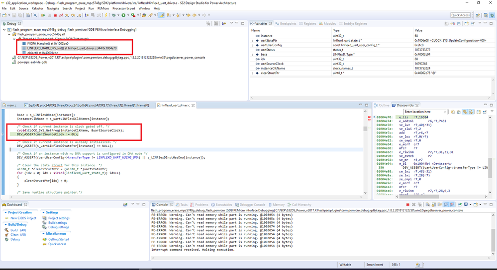

I am developing serial Bootloader for MPC57485G. flow of the the process is simple ,after every power on controller goes to bootloader code waits for 1sec to receive an file over serial uart. If the new file is received than its writes the file to application area and after completing its jump to application code. If file is not received than its directly jump to
existing application code.My application is simple of LED toggling.
I have divided flash in following manner and have made 2 separate projects for bootloader and application files of same
is also attached .

I am facing an issue that whenever i make execution jump from bootloader to application its take some time to configure
the core clock in application and whenever I try to configure any other module like uart it goes in hard fault(IVOR6_handler) and remains there only refer below image for details and highlighted code from where its goes to IVOR6_handler. Same is the case whenever I initialize any other module .
However if i removes all modules from application and just keep clock and pin initialization ,though it take some time to
configure clock here also but application work as expected

stephenlangstaf
My guess is that your application does not like the fact that your UART has already been setup by the bootloader.
Do you reset your UART (and any other peripherals used in the bootloader) before jumping to the application?

prasad_chormale
Thanks very much Stephen your suggestion is correct Resetting of the used peripherals was the missing thing.
