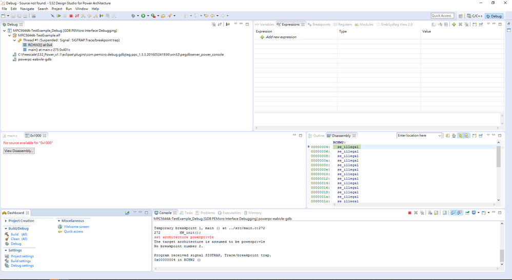

I've porting CW10.6 project into S32DS and it use MPC5644A
then CW10.6 it can be work but S32DS can not work
error message is here and attachment is source code
when i run this code i always find "Program received signal SIGTRAP, Trace/breakpoint trap.
0x00000004 in RCHW2 ()" this problem, then S32DS stop debug
Could someone can provide a MPC5644A moounted on S32DS example?

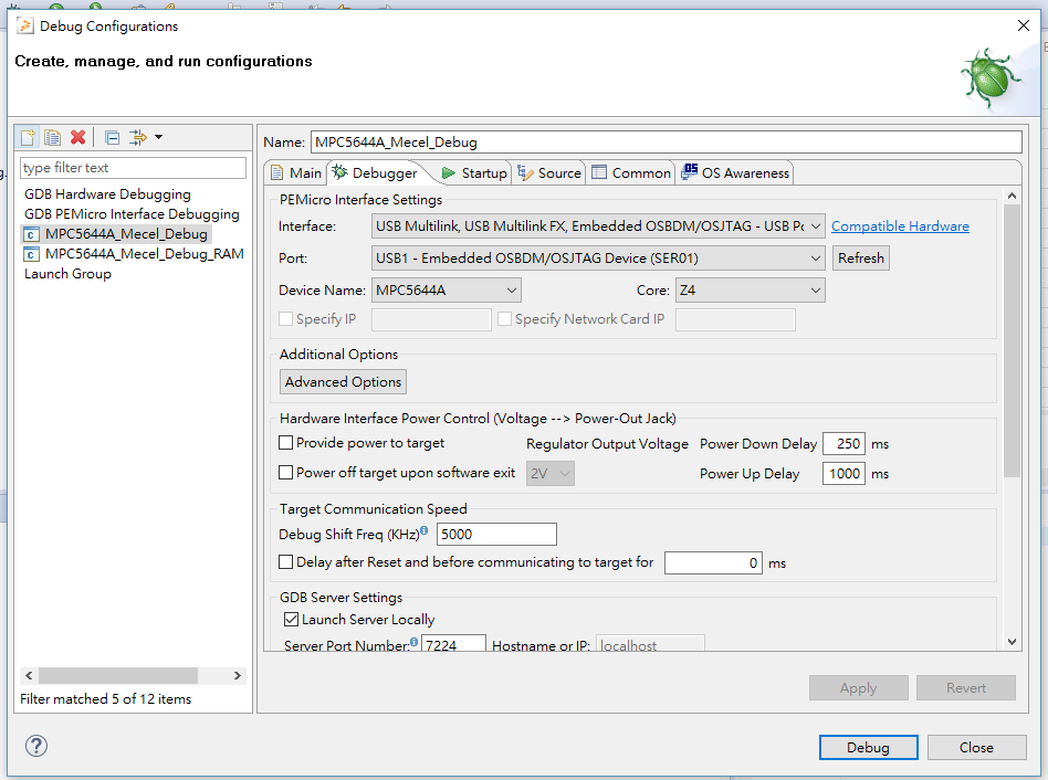

alexhuang5367
This is my problem, when i open the PIT interrupt
I'm so confuse about the error message
0x00000006 in RCHW2 ()
This page just show you what debug prob i use
