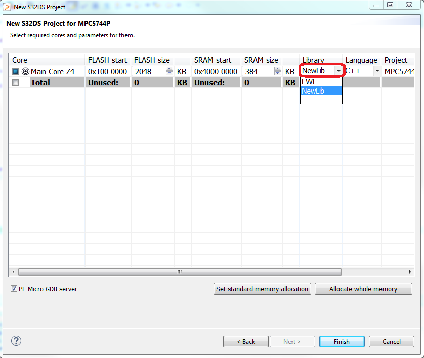

Hello Everybody!
When I add something like "int* MyInt = new int;" to a C++ project I get the following result:
Invoking: Standard S32DS C++ Linker
powerpc-eabivle-g++ -o "Basic_Z4_1.elf" "@Basic_Z4_1.args"
D:/Freescale/S32_Power_v1.0/S32DS/e200_ewl2/lib/fp/e200z4\libsupc++.a(vterminate.o): In function `__gnu_cxx::__verbose_terminate_handler()':
/home/rb501c/build_gcc_dir/build_gnu/opt/freescale/ELvle/obj_gcc/powerpc-eabivle/fp/e200z4/libstdc++-v3/libsupc++/../../../../../../src_gcc/libstdc++-v3/libsupc++/vterminate.cc:67: undefined reference to `_impure_ptr'
/home/rb501c/build_gcc_dir/build_gnu/opt/freescale/ELvle/obj_gcc/powerpc-eabivle/fp/e200z4/libstdc++-v3/libsupc++/../../../../../../src_gcc/libstdc++-v3/libsupc++/vterminate.cc:69: undefined reference to `_impure_ptr'
/home/rb501c/build_gcc_dir/build_gnu/opt/freescale/ELvle/obj_gcc/powerpc-eabivle/fp/e200z4/libstdc++-v3/libsupc++/../../../../../../src_gcc/libstdc++-v3/libsupc++/vterminate.cc:72: undefined reference to `_impure_ptr'
/home/rb501c/build_gcc_dir/build_gnu/opt/freescale/ELvle/obj_gcc/powerpc-eabivle/fp/e200z4/libstdc++-v3/libsupc++/../../../../../../src_gcc/libstdc++-v3/libsupc++/vterminate.cc:49: undefined reference to `_impure_ptr'
D:/Freescale/S32_Power_v1.0/S32DS/e200_ewl2/lib/fp/e200z4\libsupc++.a(vterminate.o):/home/rb501c/build_gcc_dir/build_gnu/opt/freescale/ELvle/obj_gcc/powerpc-eabivle/fp/e200z4/libstdc++-v3/libsupc++/../../../../../../src_gcc/libstdc++-v3/libsupc++/vterminate.cc:49: more undefined references to `_impure_ptr' follow

stanish
Hello Ville,
Thanks for your contribution on NXP Community.
You cannot link the project since you selected EWL (Embedder Warrior Libraries).
The EWL libs are built with the smallest footprint by default. Therefore the libs does not include all the features - e.g. dynamic memory allocation routines.
The easiest way is to select "Newlib" libraries in the project Wizard (see below).
Other way is to customize EWL libs (using prefix .h files) and rebuild it.
Hope it helps.
Stan

villevallinder
I changed the heap size and added an "end" definition at the beginning of the heap section, it works just fine.
One thing I noticed though is that the newlib implementation of malloc allocates a minimium of 16 bytes even for single byte types.
The overhead is used internally and is probably useful/needed when running on a platform such as Linux.
In an embedded environment with limited RAM however, it may be a good idea to use something more rudimentary.
I'm going to stick with newlib for now but probably find a way to use my proprietary implementation in the future.
Thanks for your help Stanislav!
