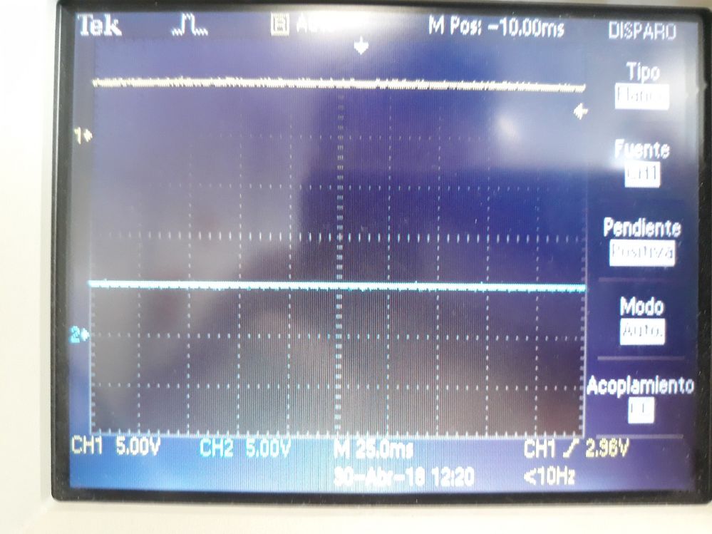

I provide a capture of the SDA and SCL signals of my osciloscope. The top one is SDA and the bottom one is the SCL.pastedImage_1.jpg

3. From the capture I observed that not even start is generated. Are you using the internal pull-ups resistors? If yes, try with external pull-up resistors of about ~4.7KOhm each.
