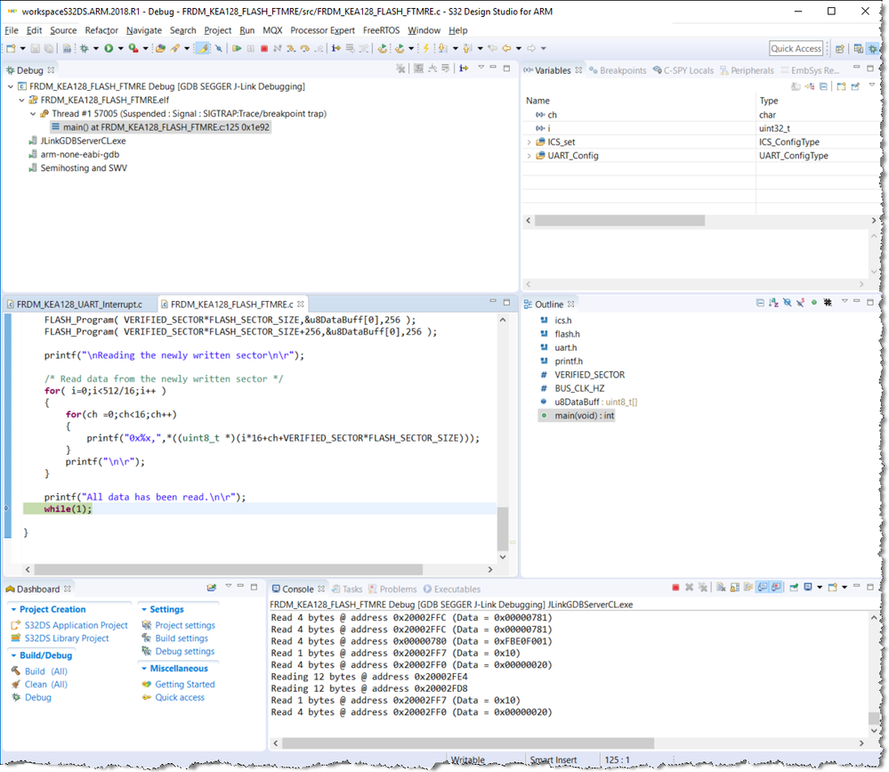

When I using FLASH_Program function.
MCU is stop working.
I try to using J-Link Debugger to oversee.

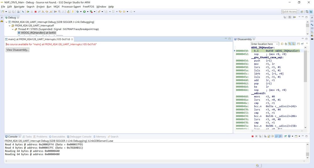

When MCU is stop working,I find this message:
I do not know what happen to MCU,I have not enable WDOG.
My program like this:

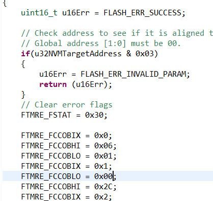

Before this I found out that when I use variables to define what command related to FLASH.
Program will crash.Like this:
If I use ordinary constants, there is no problem. Like this:
I can't understand what is going wrong here.

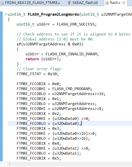

pg31321
Hi,Stanislav Sliva
Still have the same problem like video:
https://drive.google.com/open?id=1LLV8IfHT2xhNQRV6xxz3kaD3Tju3USDM
When it executes FLASH_Program2LongWords(),MCU is crash.
If the problem lies with FLASH_Program2LongWords() subroutine,I try to skip calling the subroutine and run the contents of the subroutine directly.
MCU still stuck in the WDOG_IRQHandler.
My Program like this:
https://drive.google.com/open?id=19Ve0a1u47fDBszDEih5F5akOuy4zsFGR

stanish
According to my observations this is not a hardware issue.
The exception is caused by the fact you are trying to execute function FLASH_Program2LongWords() which is located at address 0x0004000+
.text.FLASH_Program
 0x00004114 0x194 ./src/flash.o
 0x00004114 FLASH_Program
 .text.FLASH_Program1LongWord
 0x000042a8 0x134 ./src/flash.o
 0x000042a8 FLASH_Program1LongWord
 .text.FLASH_Program2LongWords
 0x000043dc 0x168 ./src/flash.o
 0x000043dc FLASH_Program2LongWords
 .text.FLASH_EraseSector
 0x00004544 0x100 ./src/flash.o
 0x00004544 FLASH_EraseSector
The flash memory sector (0x4000 .. 0x4200)  is erased by  FLASH_EraseSector() in the previous step.

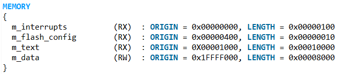

I'd recommend you to alloacate memory section for EEPROM in the linker file so the code does not get erased e.g.:
MEMORY
  m_interrupts (RX)  : ORIGIN = 0x00000000, LENGTH = 0x00000100
  m_flash_config (RX)  : ORIGIN = 0x00000400, LENGTH = 0x00000010
  my_text (RX)  : ORIGIN = 0X00004000, LENGTH = 0X00001000
  m_text (RX)  : ORIGIN = 0X00005000, LENGTH = 0X0001B000
  m_data (RW)  : ORIGIN = 0x1FFFF000, LENGTH = 0x00004000
Please try to adjust the linker file and check if the problem still appers or not.

I have to refer to the MAP file.
When I set the memory start address at 0x1000 like this:
My program uses only up to 0x572c like this:
I changed the address of erase and write at 0xc800 like this:
Still crashes in the same place.
I'm currently trying to reduce the size of the program, which may solve this problem.
P.S. After the above modifications, FLASH_Program2LongWords() address is currently at 0x3744

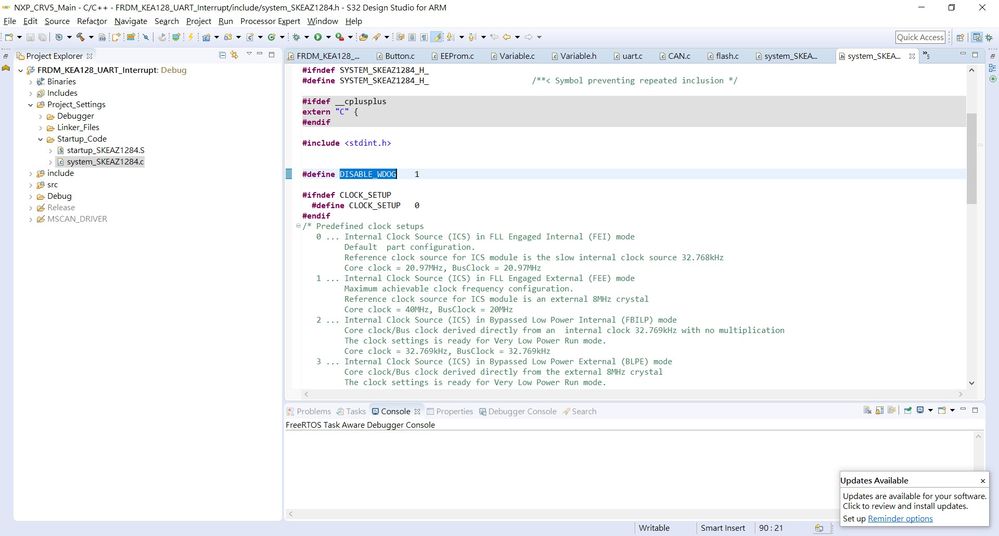

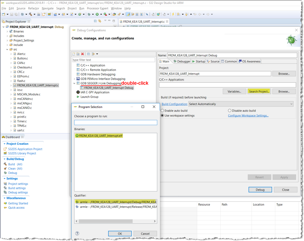

Robin_Shen
Hi 維哲,
Please check the value of DISABLE_WDOG.
Robin
8,763 Views
pg31321
Like picture:
value of DISABLE_WDOG is "1".

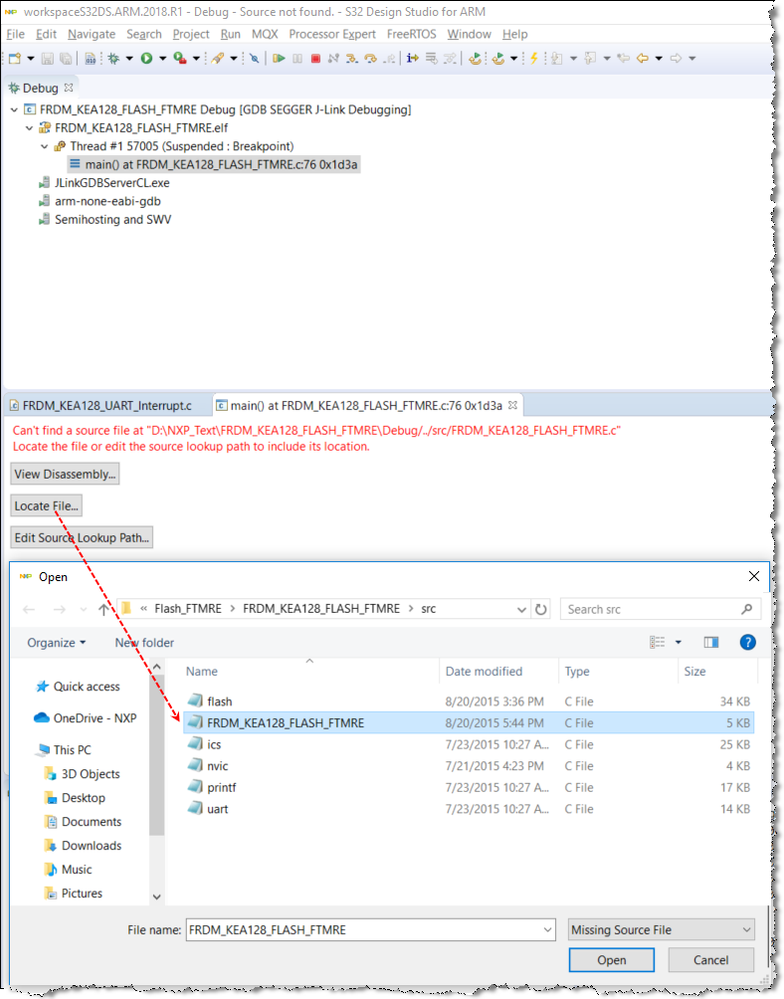

Robin_Shen

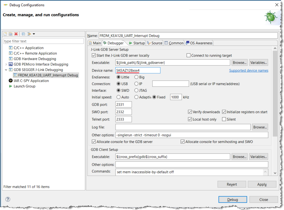

I have try to import these two project, I did not encounter similar problems.
I am using the default workspace C:\Users\xxx\workspaceS32DS.ARM.2018.R1
Shutdown
Flash_FTMRE
8,763 Views
pg31321
Hi,Robin_Shen
I using your debug setting.
It still crash.

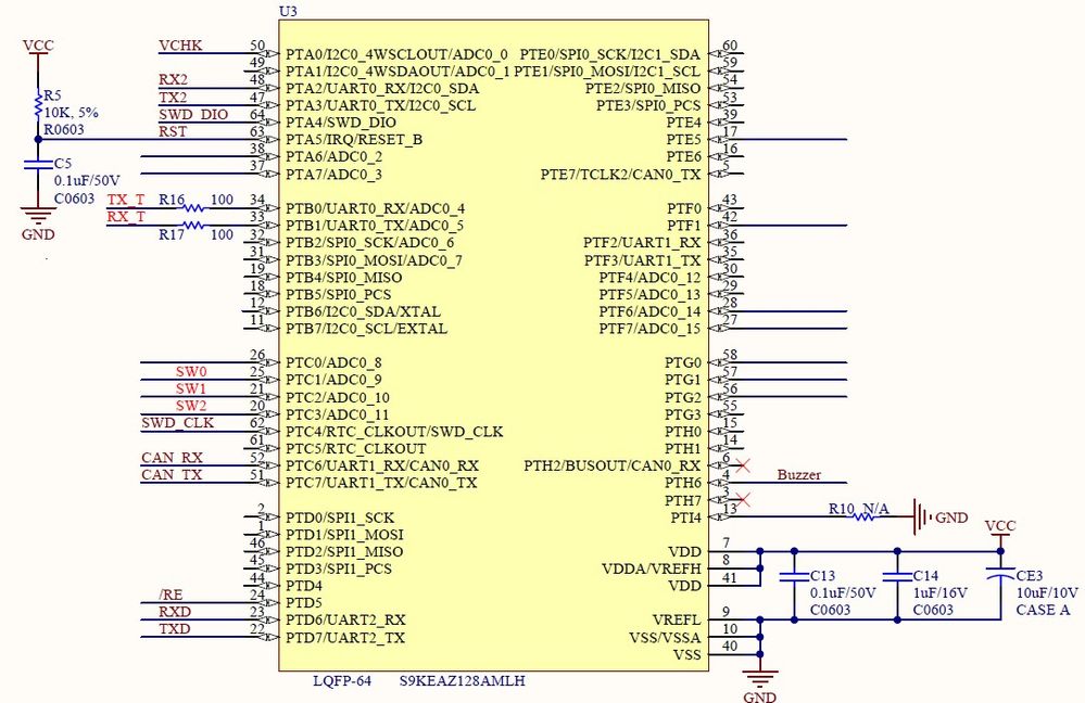

I guess there might be something wrong with my circuit.
Provide my MCU peripheral circuit diagram.
P.S. PTI4 R10 is replaced by orange light with 1K resistor in video.
