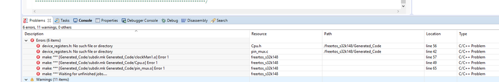

Hello ,
I have changed the tag in the processorExpert.pe from <ProjectStaticFilesGenerationMode>Linked</ProjectStaticFilesGenerationMode> to <ProjectStaticFilesGenerationMode>STANDALONE</ProjectStaticFilesGenerationMode> and I see the below related to the missing inclusion of the header files during the build as can be seen in the second snapshot.
So could you please let know how should i incorporate the changed path in the make.
Thanks and best regards!!!

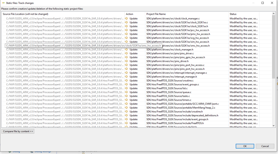

could you please write me, which version of S32DS you use and which example did you try to switch?
Have you also seen the tutorial below:
https://community.nxp.com/docs/DOC-342838

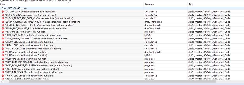

Hello ,
I made the changes as mentioned above , but I still have the issue as the below files are not getting included during the compilation.

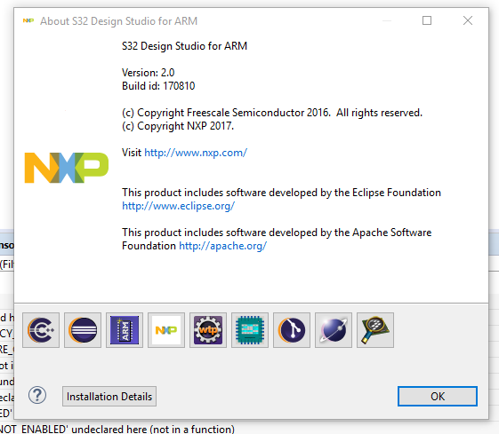

Hello ,
Sorry i Missed out to mention the version number , I make use of the version 2.0

martin_kovar
I wanted to ask you about project, but I saw you created new thread and my colleague Jiri Kral posted you some answer.
https://community.nxp.com/thread/501563
I followed the tutorial I shared above in S32DS 2.0 and it works correct on my side. You can try to clean project, generate SDK code and compile again.
