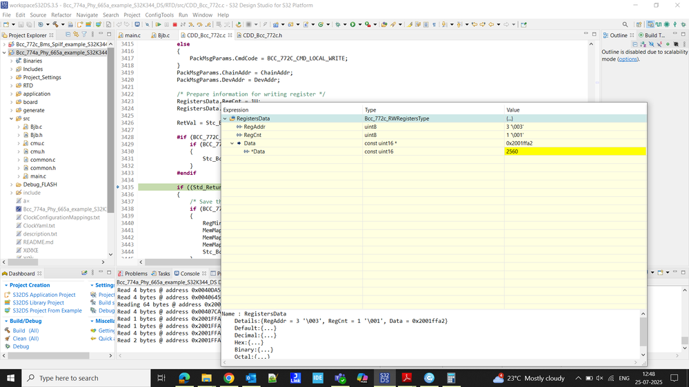

Hareesh
Hi @RafaR ,
Thank you for the support.
I have verified the SYS_CFG1 register settings during runtime, and I can confirm that the I_MEAS_EN bit (bit 9) is properly set I am writing the value 2560 (0x0A00) to SYS_CFG1 (register address 0x03), which corresponds to enabling the current measurement chain (refer attached image). The bit field breakdown confirms this:
     0x0A00 - 0000 1010 0000 0000
  • Bit 9 (I_MEAS_EN) = 1 →  Current measurement enabled
So it appears that the current measurement feature is enabled correctly on the MC33772C side.
Please let me know if there are any additional settings or steps that should be configured to successfully read the current value via TPL communication.
Thanks again for your guidance.
