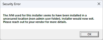

Hi!
When the "InstallAnywhere" installer tries to install S32DS V3.6 on my Windows 11 laptop I get the following error message:
It happens every time and I'm local admin and I have tried to start the installation application with local admin user rights, without any success.
I think it’s because the files are extracted to C:\Temp and "InstallAnywhere" has a problem with that.
Version 3.5 works just fine and installs without any problems on the same system.
2,845 Views
Daniel_W
I solved the problem by opening running cmd as local admin and changed the path of TMP and TEMP environment variables from C:\Temp to C:\Users\myusername\Documents\temp.
In cmd:
set TEMP=C:\Users\myusername\Documents\temp
set TMP=C:\Users\myusername\Documents\temp

Daniel_W
In cmd:
