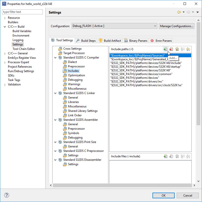

I'm facing 2 kind of issue in S32 Design studio while including the header files as shown in screenshot.
1. If i rename the folder "include" or move to with in any other folder, then compilation error will occur
2. Header files from other folders are not recognized

you need to add your custom include path into project settings. Right click on project name -> Properties -> C/C++ Build -> Settings -> Includes:
