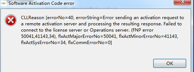

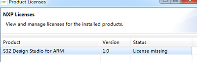

I have been using this active code(093C-B11E-A2C6-5B4C) normally for 3 years.
suddenly,I found it occurs license missing.
(IDE version:  S32 Design Studio for ARM v2018.  Windows7 64bit)
I try to input active code by clicking "Activate" button,but I get the following error message:
Any help regarding this issue is greatly appreciated!

I have extended your entitlement through 2025, please re-activate your installation using the existing activation code.
Apologies for the delay in reply, this was posted to the wrong community and I only just became aware of it.
