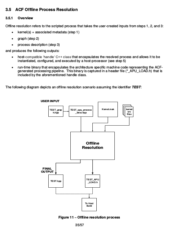

I am trying to build ACF project code for S32v VSDK.
I saw the ACF guide, graphing the desired function, and making it into a program.
I write the graph file myGraph_graph.hpp and myProcess_proc_desc.hpppastedImage_1.png
In Next step, User_Guide says "ACF Offline Process Resolution has to be performed."
but I don't know how to do this.
Is "Offline resolution process" not necessary?
How I this two header files generate?
Help me please

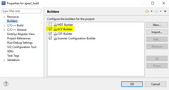

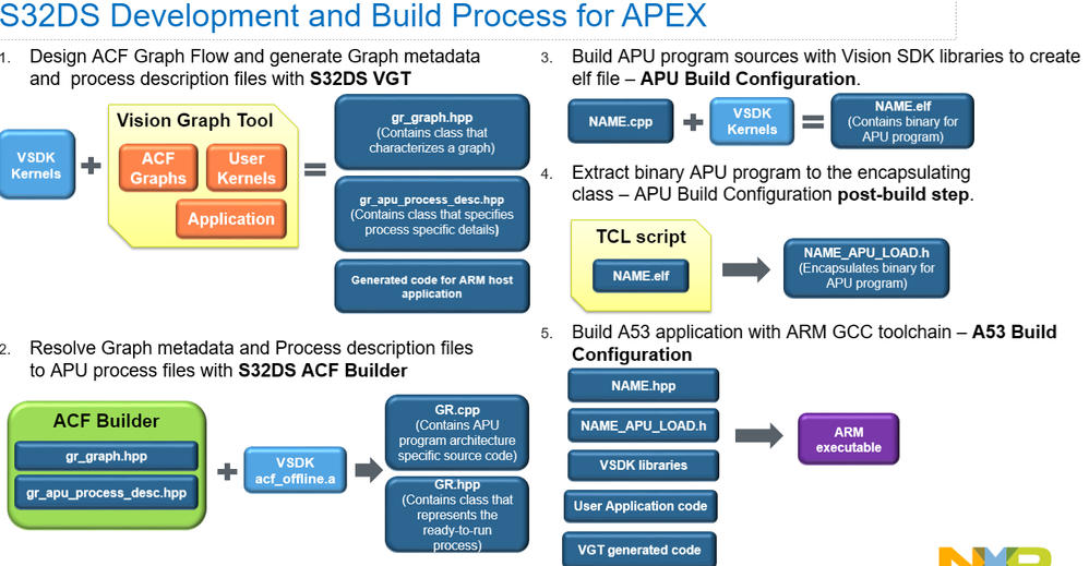

Hello Hyoungwoong,
Do you use Design Studio for your APEX project? DS uses ACF Builder for offline process resolution process.
Let me know if you want more information about build process for APEX in Design Studio.
