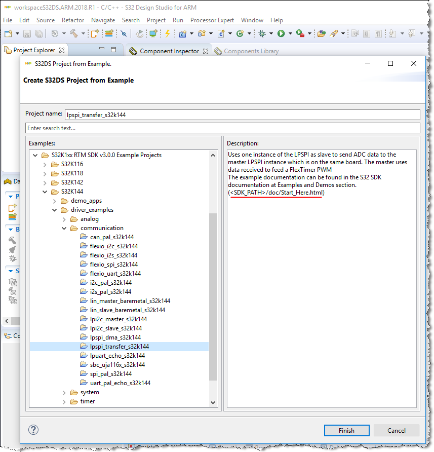

Hi Veeraju,
For S32K1xx, the recommended SDK version to use is S32K1xx SDK RTM3.0.0 with UP10(SR3.0.1) and 11(SR3.0.2) installed;
Then you can refer the example in SDK

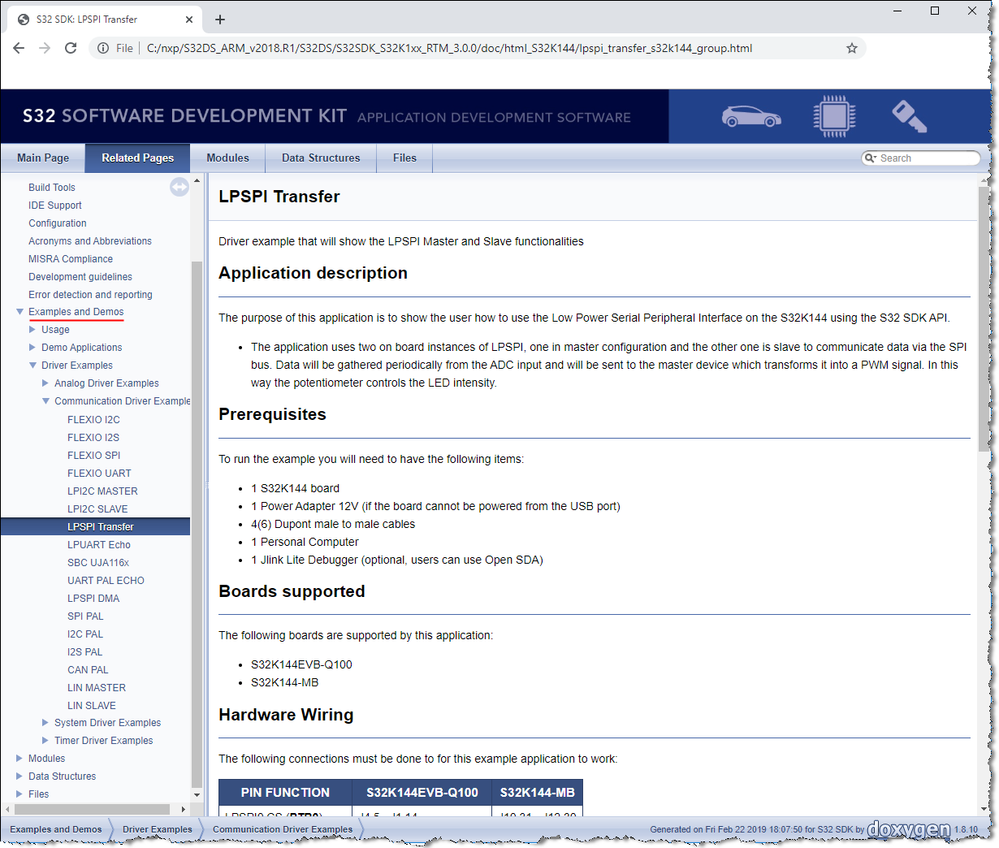

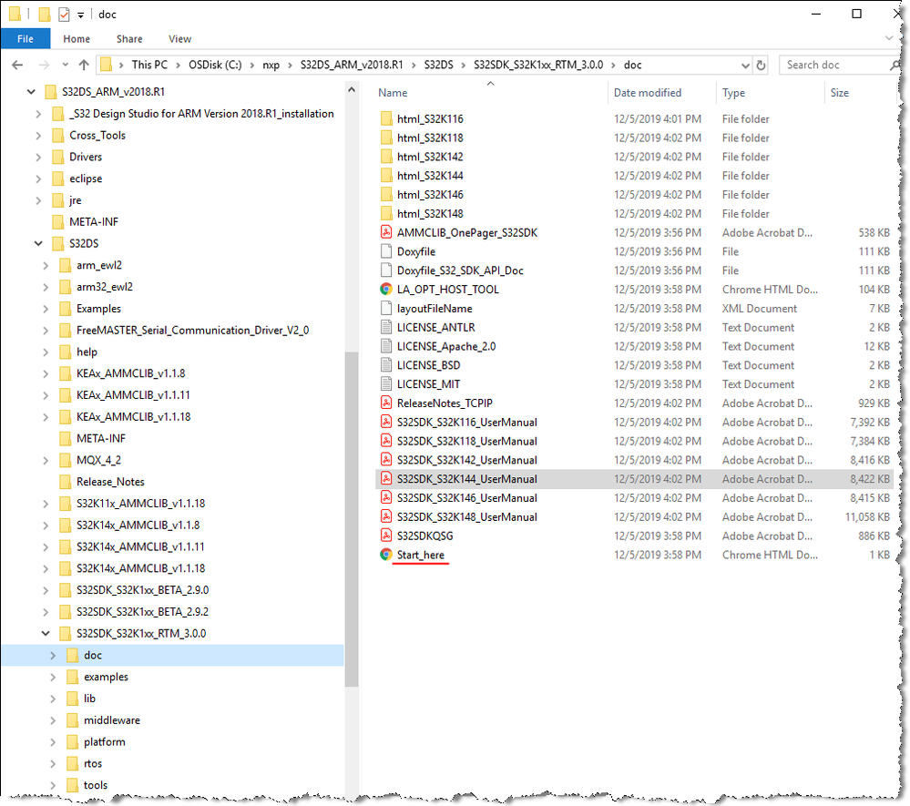

Then you can find the "Start_here.html" in it's folder:

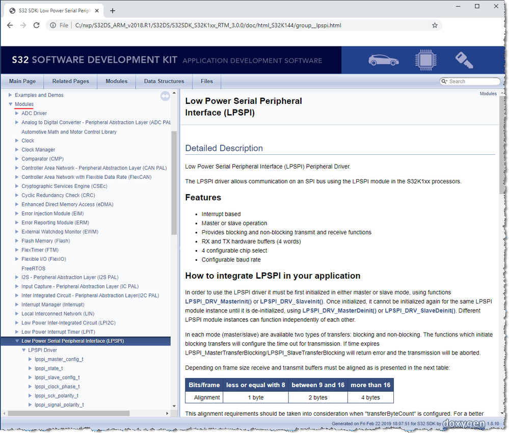

You may need to read "examples and demos" and "Modules"
