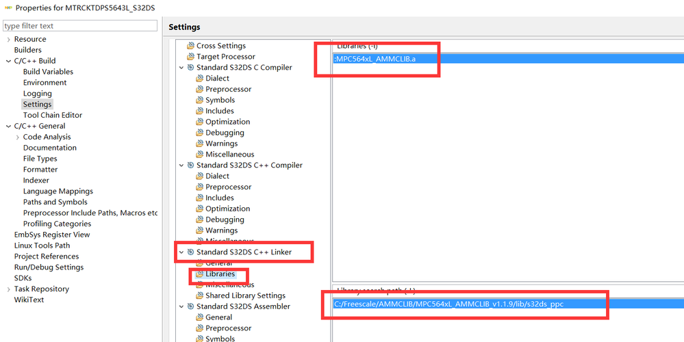

I am sorry to tell you that the ERROR is still there,as your said my operation shown below:
My configure as below:
1#:
2#:
3#:
4#
5#
then my debug result shown as below:

Hi jiri,
I replace the files that 56xx_flash.ld and 56xx_ram.ld,but the Error still there.
Shown as below:

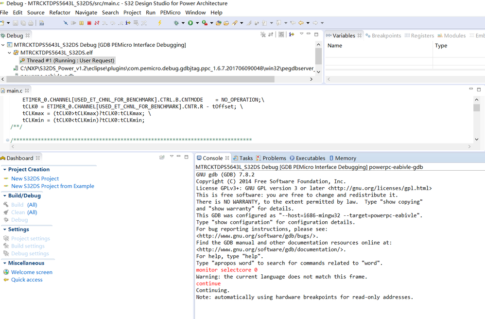

Well - from your console log - I don't see any error. Program reach break point at the beginning of main function and debugger is waiting for action. Can you share screenshot of S32DS with error state? - in case that you are still have debug error.
Jiri
