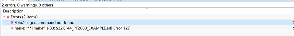

In order to use the FRDMPKPT2000EVM model evaluation board, I downloaded S32 Design Studio for ARM Version 2.2 followed the section 6. in the User Manual.and imported the 'S32K144-PT2000-EXAMPLE' file into the software.But when I imported it, I encountered the following problem:
1)After importing the example file, the problem column of S32 designer studio displays the following errors and warnings.

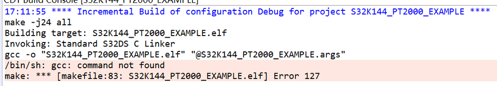

The error are /bin/sh: gcc: command not found and make: *** [makefile:83: S32K144_PT2000_EXAMPLE.elf] Error 127.

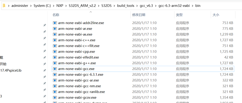

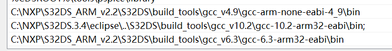

I have tried the solutions provided in other questions by changing the environmental variables of my computer and adding the corresponding values.
However, the problem still hasn't been solved. Version V2.2 is the one I downloaded by referring to other solved issues. Is it a configuration issue?
2)About error 127,I haven't used Symantec software, and I have turned off the firewall and antivirus software on my computer, but the problem still hasn't been solved. Is error1 the cause of this issue?

Hi @Doublemint,
I believe the S32K144-PT2000-EXAMPLE was designed with an older version of Design Studio, S32DS for ARM 2.2 comes with a different version of the S32K1 SDK. Try installing S32DS for ARM 2.0 and importing the project.

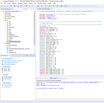

I tried to compile the program using the V2.0 version software as you suggested, and it did solve the previous issues. However, new problems have emerged.
1. After clicking the hammer button to build, the compilation did not succeed, but no error was displayed. It just showed that no action was taken.
2. After using Pt2000 dev studio to generate new pt2000load.c and .h files, and replacing them, the compilation still behaved the same way.

Hi @Doublemint,
This is probably because an already existing build configuration is present in the project. You can clean and build the project again to delete the existing Debug folder and create a new one.
