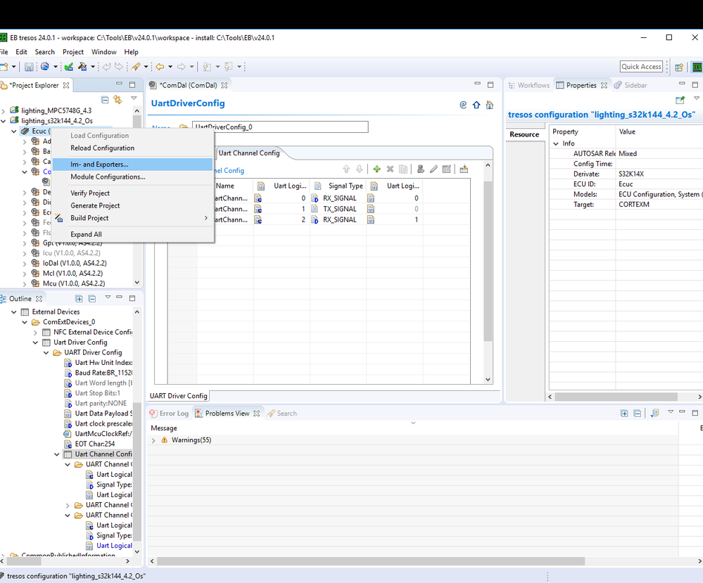

but I had some problem with Load error. blow is that thingspastedImage_3.png
and I didn't anything so I did download other version MCAL software(Tresos Studio 24.1.0, SW574XG-MCAL431-RTMC_1.0.0)
so, the load error is fine and we got the Warnings, however, I click the generate file, it has a lot of error. blow is that things

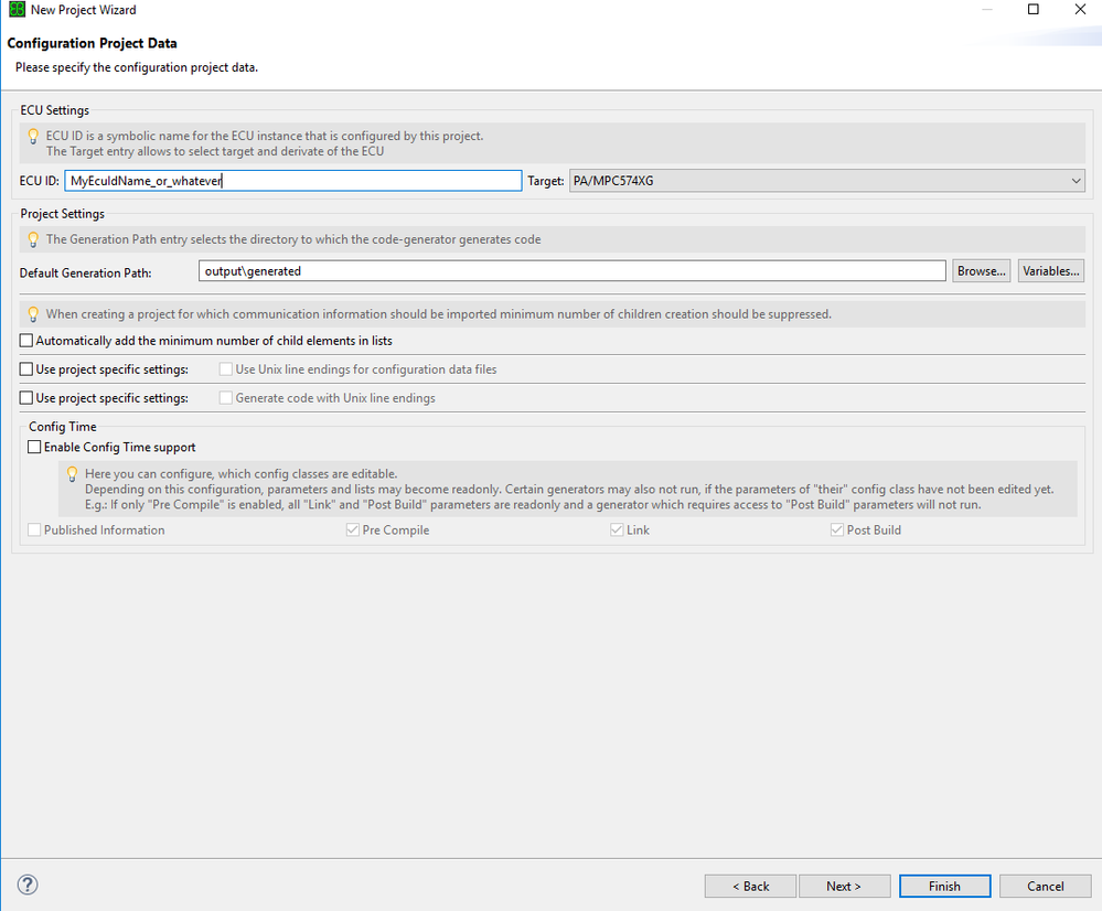

add platform specific information...
Note. for MCAL configuration Ecu ID in not really important. However, for a series project where other ASR components will be configured, it may be a good idea to have this name consistent with the ecuc name where you will store the entire BSW configuration (though import options should work nevertheless)

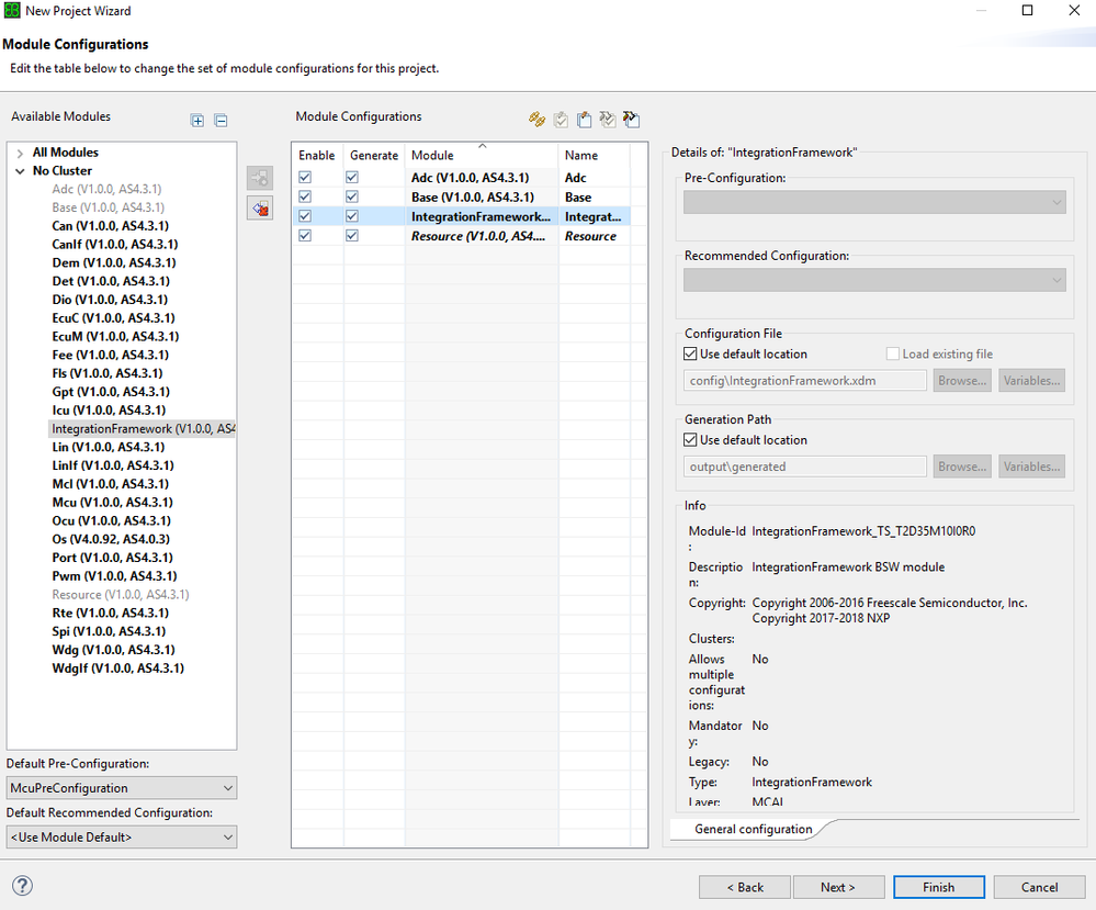

Press next (not finish) so you can add which modules you want to use...
The MPC574xG ASR4.3 RTM100 release should contain the following modules configured as part of the "sample application" which is, now, called "Integration framework": Adc, Base, Dio, Gpt, Ocu, Mcl, Mcu, Pwm, Port. You need to add all these modules to the configuration and press finish.
Your project should now be created and you should have access to un-configured modules. you need now to import the epc files that where provided for the release by pressing right-mouse-click on the new project to open the context menu import option:

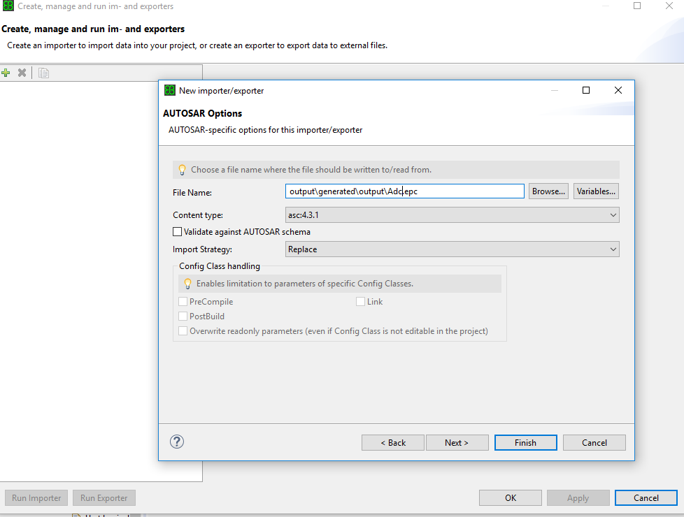

Press the green plus from the next window and this will create an 'importer' for each module... Adc_import.PNG
Pressing Next will allow you to configure from where to actually import the file. Make sure to use 'Replace' as Import Strategy, to avoid mixing types and also Content type should be: asc:4.3.1 (or what ever ASR release version you are using).
Browse to the output folder where the epc files are stored (on your machine), select the corresponding module and press finish.
Press Run Importer button and you should have an up-to-date ADC configuration... Rinse and repeat for all other modules ... and you should be able to generate the code...
