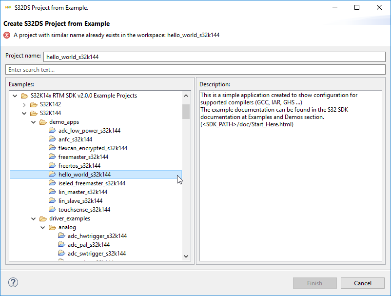

 I am fresh man for S32 DS. I install the S32 Design Studio for ARM and follow the Get start Video Blink LED from Example V2, But It is strange that I can't find this example in my PC.
Then I try to Created project  follow the video Blink LED Recreate Example V2.  After set the pin , The Component  pin_mux is different with the video. And the ProcessorExpert.pe have a Slash on it.
Wish for Help!
Thanks very much!

The blinking led example was part of Beta SDK v0.9.0 and is not present in newer SDKs.
you can use hello_world_s32k144 isnstead - it has the very same functionality as blinking_led example.
About processor expert/pin mux - again - the video was done with previous S32DS version and some details differs from current version. But the principle remains same.
