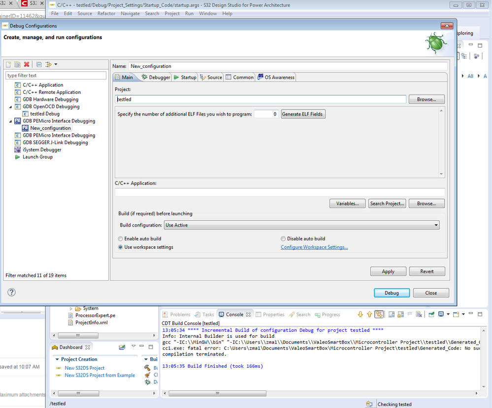

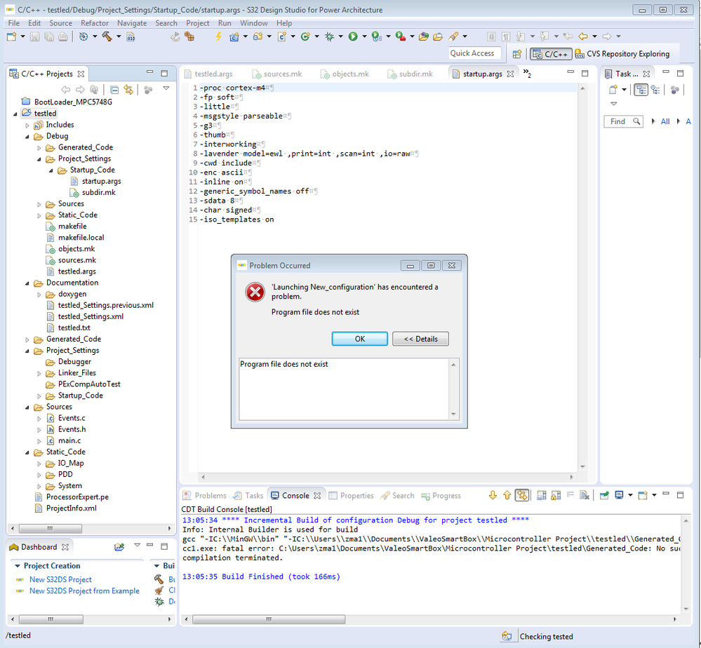

I started this with a plain computer(only has windows 7). I use to have error like"fatal error no such file or directory" and "gcc/g++ not found in the PATH". After I installed MinGW and included path and built it, I dont have problems. But when I go debug I do not have the .elf file and it shows "Program file does not exist".pastedImage_1.pngAnd here is my setting pastedImage_2.png
I have worked on this for a long time. Really tried every solution on this website and anything I could find on Google. Can someone give me some assistance. I will be much appreciated.

stanish
I suspect this project was created in Processor Expert Software, Microcontroller Driver Suite:
Processor Expert Software, Microcontroller Driver Suite|NXP
I'd recommend you to download it and import the project there.
There are many dependencies to Processor Expert plugins which are not supported by S32DS for ARM.
Hope it helps.
Stan

zhenanma
Also at the Debug Configuration, I could find PE micro debugger which I suppose I should use for my MCU? Do I need to install through help? Or maybe PE micro is not the right debugger?
8,203 Views
stanish
I don't think you can use standalone Processor Expert Software to debug generated project.
The main goal of the tool is to generate C init/driver code which you can then build in any other tool like CodeWarrior.
If you manage to generate an .elf file you can program and debug it in S32 Design Studio. I'd recommend you to use option 2."Executable file importer":

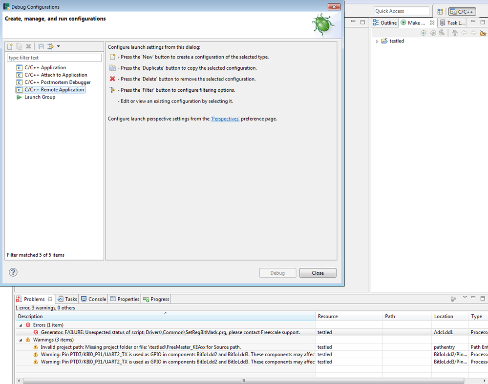

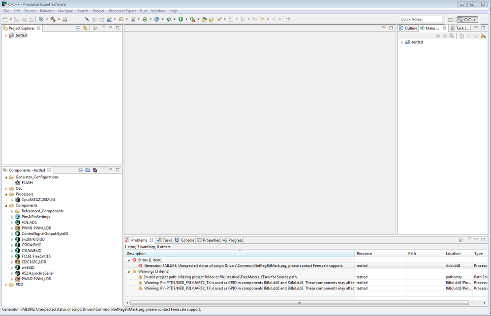

Regarding the generator FAILURE: I'd recommend you to submit your question here:
https://community.nxp.com/community/pex
Hope it helps.
Stan
8,203 Views
zhenanma
Processor Expert error 2.PNGCan u take a look at this error? It asks me to contact freescale support.
8,203 Views

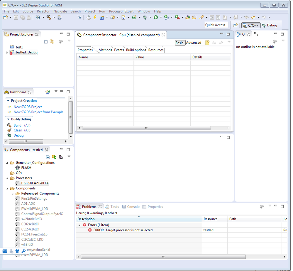

Thank you for your help. After I installed  S32DS for ARM ver. 1.3.I ran into some new issues."ERROR: Target processor is not selected" Which I have never ran into before using 1.2 version.pastedImage_1.png
8,203 Views
stanish
I'm wondering where you crated this SDK/processor expert based project.
S32DS for ARM does not support this type of project for KEA derivative.
The only SDK available for KEA is set of drivers (Example quality code) and has no graphical interface to setup.
Stan
