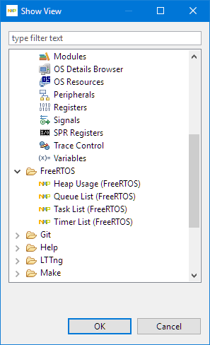

You should be able to use the FreeRTOS views:
They work for any GDB based debug connection (see as well Better FreeRTOS Debugging in Eclipse).

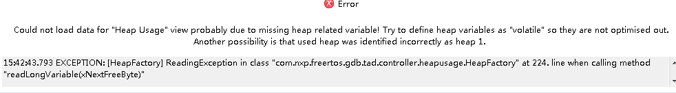

      I  have already install the Task-aware Debugger. I could see this Task list ,but when i open the heap usage tag,the software show an error.
      how to solve this problem?Should I make a configuration for this plugin?

As noted in that error message, it could be because of optimizations. Have you turned off optimizations to see if it helps? The plugin tries to use variables from the FreeRTOS heap implementation to find out what heap scheme is used.

I have checked the project settings.The optimiztions level is None(-O0),and the debug level is Max (-g3).
Maybe it doesn't support this chip(MPC5748G) or s32ds software..  :smileysad:

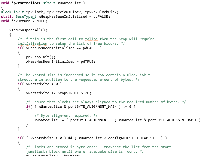

BTW,i used heap_2.c to implement heap allocation.
