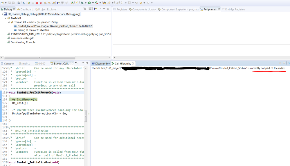

How to view the call hierarchy When using the S32Studio tool to debug ELF files generated by greenhills
2,581 Views
331447791
build and link environment:  greenhill  comp_201714
build cmd : -cpu=cortexm4 -noobj --long_long -G -dual_debug -farcalls -dwarf2 -no_misalign_pack -nostartfiles
S32 Design Studio version:
Version: 2018.R1
Build id: 180326
I used greenhill to build and generated elf file.  when debug with elf file and open call hierarchy window I always see that.  how the view the call hierarchy?

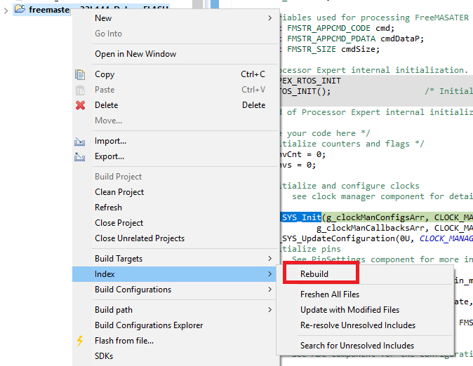

Could you try to re-index the project:

331447791
Hi  Stanislav:
I have try to Index rebuild operation. but still can not  view the call hierarchy. S32 Design Studio did not anything when executing index rebuild operation .   Do Must use the S32 Design Studio build source and then to executing  this operation?

jiri_kral
what is your target MCU?
Jiri
2,412 Views
331447791
S32K148
