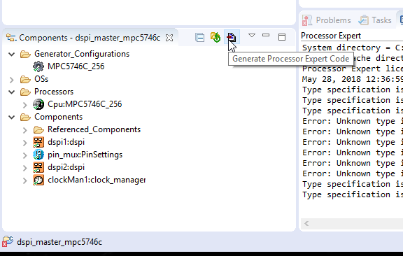

I'm trying to find way how to generate Processor Expert code from command line. Meanwhile you can just generate them from GUI (the content is not erased by clean). Just click on generate processor expert code in S32DS IDE:
and close S32DS. Then you can be able build your project from command line - if there are no other errors. In my case I'm using for test purposes SDK example dspi_master_mpc5746c. Here is console command for my environment (PE code already generated from GUI):
c:\NXP\S32DS_Power_v2017.R1\eclipse\eclipsec.exe -noSplash -application org.eclipse.cdt.managedbuilder.core.headlessbuild -data .\ -cleanBuild dspi_master_mpc5746c

      I tried to do what you said. First click on the button on the eclipse button, then close the eclipse, and finally use the command to compile. Unfortunately, there are still problems with compilation failure. :smileycry::smileycry:
      As you said, the project will generate Processor Expert code  first, and then execute the -cleanbuild command?

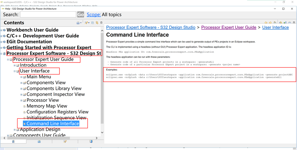

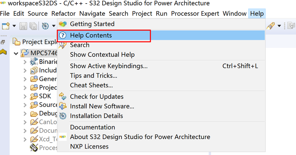

      I found some information about generating Processor Expert code from command line from the S32ds help documentation.:smileyhappy:
I executed this code based on this command line.
eclipsec.exe -noSplash -data D:\test -application com.freescale.processorexpert.core.PExApplication -generate MPC5746C_App_Z4

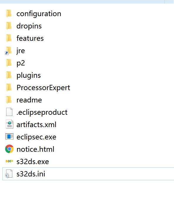

279599829
Dear Jiri:
    I found that the content of this link is not helpful to me. There is no similar available file in my eclipse folder. I also didn't find too much command line information from the help documentation of S32 Design Studio.
   Are there other ways to tell me?
