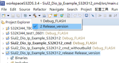

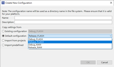

I follow the link as below to add released build. (Design Studio 4.4)
https://community.nxp.com/t5/S32-Design-Studio/Debug-options-to-select-in-S32-Design-Studio/td-p/698...

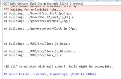

Released version follow below link, choose Release build, but
I create the Siul2_Dio_Ip_Example_S32K312 and add/choose the Release build. (There are some errors.)
2,856 Views
mikedoidge
Hello Stephen,
I'm not sure what you are trying to do. The link you shared does not show how to add a release build option. I suggest you use the details I provided in this thread:
https://community.nxp.com/t5/S32-Design-Studio/s32-DS-2018-build-configuration/td-p/1430922
I think you will find this to be more successful.

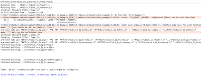

What's interesting is the error reported in the image you shared shows the issue is with a macro used in 'check_example.h', which is not part of the build to begin with. See here:
The greyed appearance of the folder and filename along with the slash on the icons for each is clear indication that they are excluded from the build.
Mike

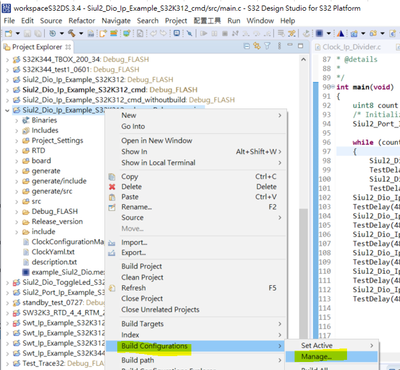

StephenYeh
Hi Mike
I reference the modify code based to released version follow below link, choose Release build, but there are some errors.
My test step as below. (Debug Flash is OK, but released version will fail)

mikedoidge
Hello @StephenYeh,
I tried the steps you prefer to follow, and I was able to reproduce the errors you received.
Next, I followed the steps I encouraged you to follow and the code built without errors.
