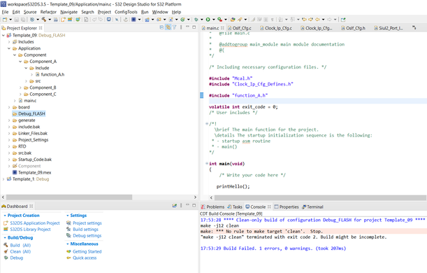

Hi Community,
I'm facing trouble with the S32 Design Studio IDE. My project's "Components" folder/files aren't compiling or being included in the build, despite following the recommended directory structure. I've tried multiple such as:
  • Open your S32 Design Studio project.
  • Navigate to the "Project" menu and select "Properties."
  • In the properties dialog, go to "C/C++ General" > "Paths and Symbols."
  • Under the "Source Location" tab, ensure that the path to your "Components" folder is included. If not, add it.
But no success. Please find the attached image that shows the structure that I want I want to compile.
Could you please advise on how to configure the build settings correctly and ensure the "Components_A, B, and C" files are included? Any insights or steps would be appreciated.

it is possible share your test project?

Hi @jiri_kral i resolved the problem using the following configuration.
*Open your S32 Design Studio project.
*Navigate to the "Project" menu and select "Properties."
*In the properties dialog, go to "C/C++ General" > "Paths and Symbols."
*Under the "Source Location" tab, ensure that the path to your Components" folder is included. If not, add it.
