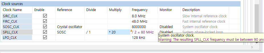

I would like to use FS32K144HFT0xxxx MCU.
The MCU's core frequency is 80MHz.
So I try to set SPLL clock to 80MHz with SKD_S32K14x_09 in S32 design studio for ARM.2018.R1
But I could not set SPLL clock to 80MHz, because of below warning.
Is it possible to set SPLL clock to 80MHz?
If it is possible, how to set 80MHz?

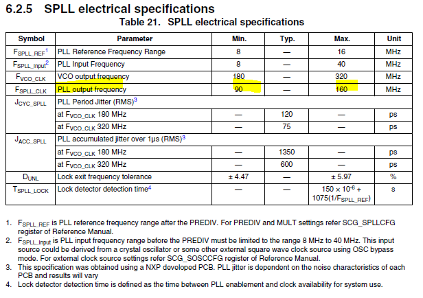

jiri_kral
based on this AN - https://www.nxp.com/docs/en/application-note/AN5408.pdf  the supported range for SPLL is 90-160 MHz.

kbj
Dear Jiri,
As your comment, SPLL frequency spec is below.
In case of FS32K144HFT0xxxx MCU, Core frequency is 80MHz.
If I set the SPLL clock of FS32K144HFT0xxxx to 90MHz, Is there any problem in operation?

jiri_kral
the 90MHz is in range  So I'm not expecting any issues.

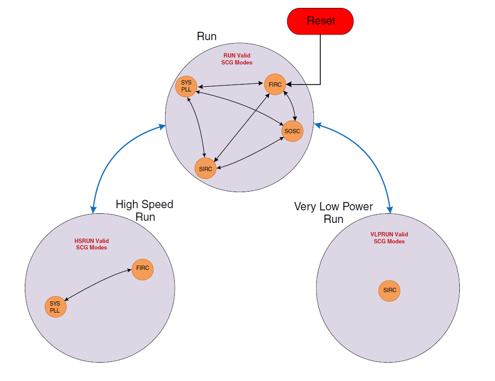

jiri_kral
Hi Byungiju,
The core clock depends on Run mode. In HSRUN - the core clock should be 112MHz, in normal RUN 80MHz and so on. Please look at chapter 27-30 in reference manual - page 533+ https://www.nxp.com/docs/en/reference-manual/S32K-RM.pdf

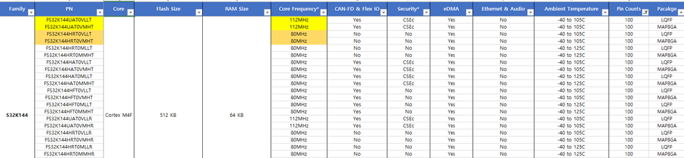

1. What does the Core Frequency in the EXCEL table below mean?
2. If the core frequency is the frequency of normal RUN mode, how do you set it to 80MHz? (If you set it to FIRC, it is max. 60Mhz.)
Byungju.
3,822 Views
jiri_kral

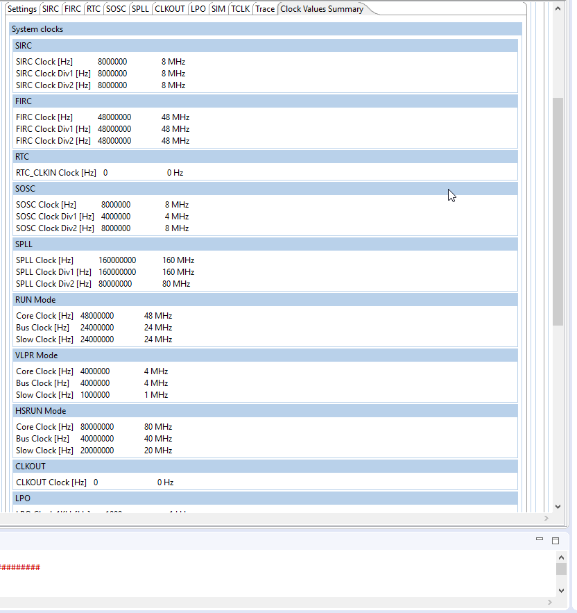

The 80MHz in the table means that ARM core can run on 80MHz or less.
can you share your project? I'm not able set for example FIRC to 60MHz on my project. To check final values is better look at the Clock values summary page:

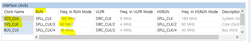

As you do, I set SYS_CLK of RUN mode to 80MHz.
