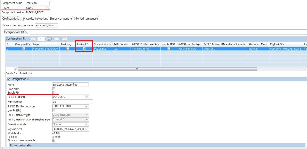

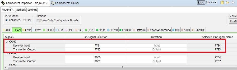

■ CAN-FD related Component Inspector
 - Device : CAN0
 - Enable FD : checked
 - CAN 0 selected

I received following answer from SDK team:
On behalf of the FlexCAN driver developer:
After running multiple tests for FlexCAN FD transmissions, no issue was found on our side.
We identified the following situation in which FLEXCAN_DRV_IRQHandler() is called, but FLEXCAN_DVR_CompleteTransfer() is never reached: the sending node does not receive 'ACK' from the receiving node (nodes are configured with different bitrate, FlexCAN module is not initialized on the receiving node). In this situation state->mbs[mb_idx].state remains FLEXCAN_MB_TX_BUSY as it is set by FLEXCAN_DRV_StartSendData(), but is never changed to FLEXCAN_MB_TX_IDLE as FLEXCAN_DRV_CompleteTransfer() is never called.
In order to further investigate the problem, could you inspect the state of the Error and Status 1 register by calling FLEXCAN_HAL_GetErrStatus() after FLEXCAN_DRV_Send() and let us know the result?
Also, please make sure that all fields from the flexcan_data_info_t structure are correctly set:
flexcan_data_info_t dataInfo_FD =
.data_length = 1U,
.msg_id_type = FLEXCAN_MSG_ID_STD,
.enable_brs = true,
.fd_enable = true,
.fd_padding = 0U,
.is_remote = false /*!< Specifies if the frame is standard or remote */
Also, we are confused related to the following statement:
 - did not call 'FLEXCAN_DRV_IRQHandler()' -> call 'FLEXCAN_DRV_CompleteTransfer()'
Is FLEXCAN_DRV_IRQHandler called? If not, how come FLEXCAN_DRV_CompleteTransfer() is called? If FLEXCAN_DRV_IRQHandler is invoked, does it reach FLEXCAN_DRV_CompleteTransfer()?
