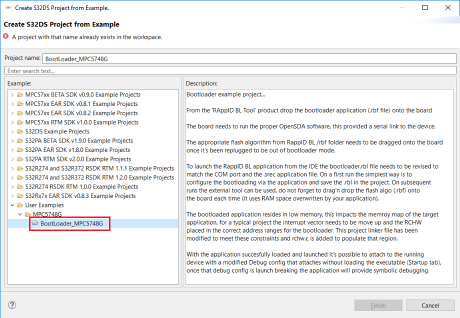

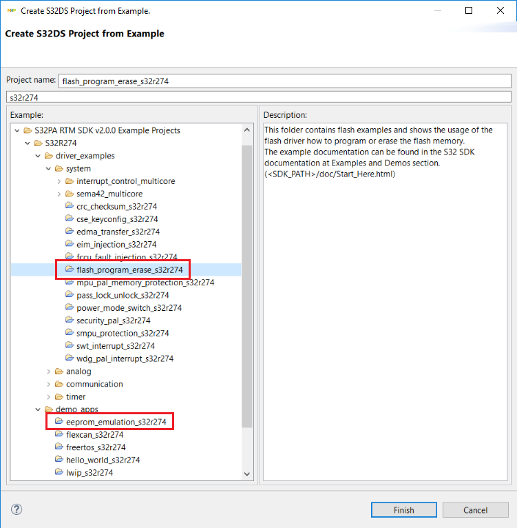

1. Is there any driver and example of EEPROM and Flash?
2. How to create a bootloader project, because when I create a new project will create three projects(Z4,Z7-0,Z7-1)?

First, make sure you have installed https://www.nxp.com/lgfiles/updates/S32DS/S32DS_PA_v2017.R1_UP9.zip
Next, go to New -> S32DS Project from Example. Enter s321R274 in the search field. You should see example projects 'flash_program_erase_s32r274' and 'eeprom_emulation_s32r274'.
Then, if you clear the search field and scroll to the bottom of the list, you can see the example project 'BootLoader_MPC5748G'. Though it is for the MPC5748G and not S32R274, it should provide some reference to you on creating a bootloader project.
