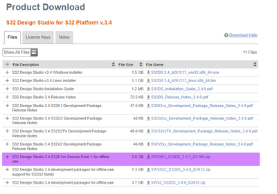

The migration feature works with SDK and Expert Processor based projects. Check if your project has any SDK attached. Go to Project Properties -> SDK.
Also, make sure you have installed S32SDK S32K1XX RTM 4.0.2 (S32 Design Studio 3.4 S32K1xx Service Pack 1 > S32 Design Studio IDE > S32 Design Studio for S32 Platform v.3.4).
