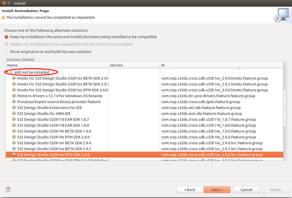

I want to compile a project in ubunt16.04 environment, and this project is based on SDK3.0.0.
I did some steps in ubuntu environment:
1. Install <S32DS_ARM_Linux_v2018.R1.bin>
2. Open S32DS tool and execute help-> Check for Update
3.Downloaded and installed <S32 Design Studio for ARM 2018.R1 Update 11>
However, during the process, the following content is always displayed:
Why can't I install S32SDK_S32K1xx_RTM_3.0.0?
4 返答(返信)
3,348件の閲覧回数
jiri_kral
Bad news - I got confirmation from SDK team that SDK is still not supported on Linux host. Please see release notes. Sorry for inconviences.
