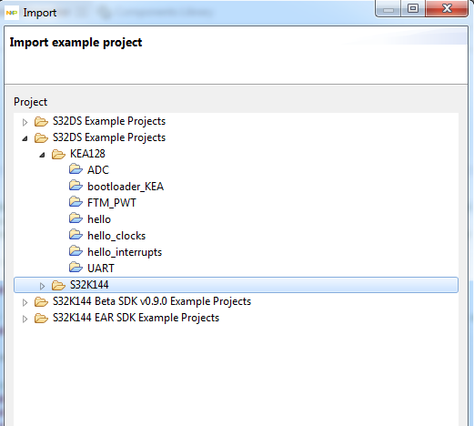

I'd recommend you to create a new project and transfer the source files manually.
Or you can check the examples delivered with S32 Design studio (File -> New -> New S32DS project from template):
Hope it helps.
Stan

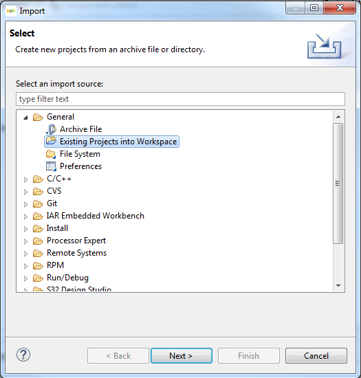

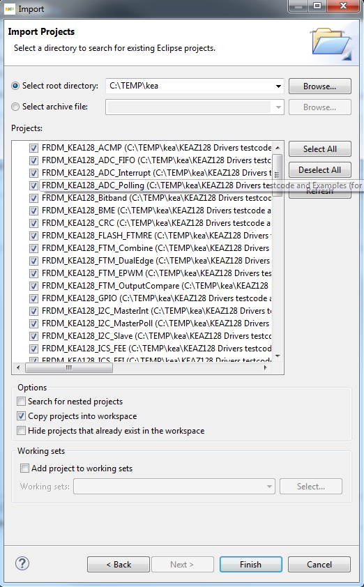

stanish
1) go to Menu File -> Import
2) Select General\Existing Projects into Workspace
3) select directory with the examples:
Select which individual examples you would like to import (you can physically copy the projects into workspace) and press Finish button.

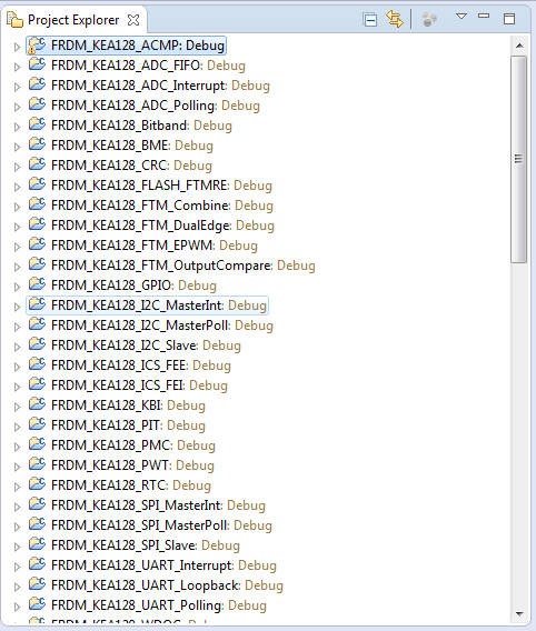

4) finally the projects should appear in your workspace
Hope it helps.
Stan
