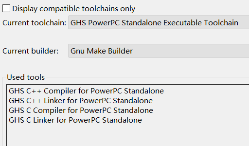

Hi:
In S32R274 project,I want to use MCAL,so used toolchain is "GHS PowerPC Standalone Executable Toolchain",but I can not found SPT Assembler、SPT Disassembler、SPT Preprocessor, these three tool only enable "Standard S32DS toolchain for E200 ".
SPT use assembly  not C language,So I need SPT Assembler。
Can someone help me?

the SPT assebly and SPT object dump binaries are located in
[YOUR_S32DS_INSTALL]\S32DS_Power_v2017.R1\S32DS\SPT2\
I'm not sure if GHS supports SPT, but you can build your SPT code as standalone project with our SPT assembly and link object file in your code.
Jiri

Hi Jiri
Thank you for your reply。
I know SPT enable at this picture。and if use "Standard S32DS toolchain for E200 ",I will find some tool,like follow picture
if use "GHS PowerPC Standalone Executable Toolchain",like follow picture
may be this picture can make you understand what i want say。
you mean that make SPT code as libs,than link these libs to my project?

jiri_kral
I mean output from spt assembly - If I'm correct .ospt object file. You can link this object file in your project. The solution may be to have two projects - for SPT - and second project for rest C/C++ sources.
