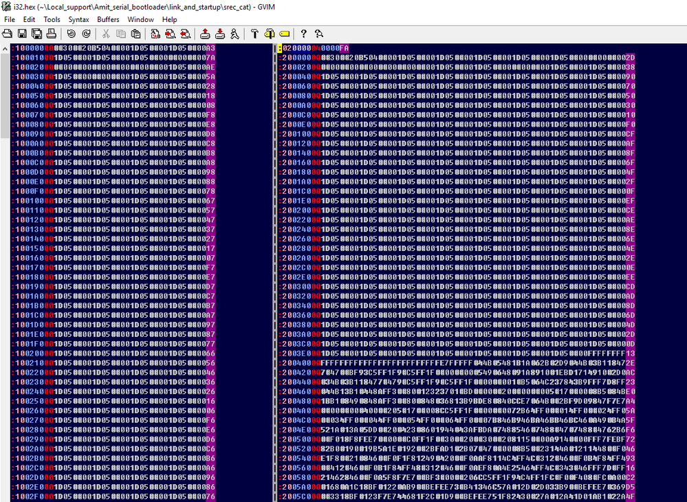

As we are trying to generate .hex file, default its generating with record type as Extended segment address( type 2) .We need .hex file with extended linear address(type 4).Please let me know any changes need to be done.

it looks that arm-none-eabi-objcopy can generate only Type 2 intel hex or at least I didn't find way how to force i32hex output. As a workaround you can use external srecord tool:
SRecord 1.64
and convert .hex output to i32hex by:
srec_cat.exe test.hex -intel -o i32_test.hex -Intel
console command.
Here is result example - on the left is .hex file generated by S32DS - on the right output from srec_cat tool:
Hope it helps.
