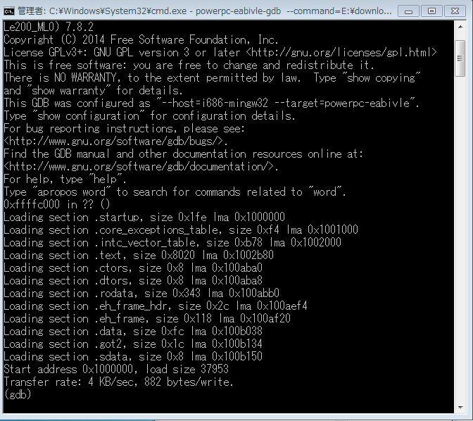

In S32 Design Studio installed path(C:\NXP\S32DS_Power_v2017.R1\eclipse\plugins\com.pemicro.debug.gdbjtag.ppc_1.7.2.201709281658\win32), I execute following command:
pegdbserver_power_console.exe -startserver -device=MPC5744P
Then I execute the commands I descriped in Method 1, the cmd figure is shown as following:
I don't know the difference between above two methods.
And another question,  in method 2, When I see the message (Transfer rate: 4 KB/sec, 882 bytes/write.)
Does it mean that the program is uploaded into the board? The program is running ? If I want to stop the run of program, I just use 'stop' in CMD window?

the error is probably caused by backslash in your load command - E:\ . The gdb client comes from Linux where is used normal slash for directory separator. It should work with load E:/download/examples...
Yes, program was uploaded into device. Here is summary of most common commands:
