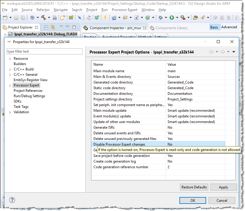

When I creat a new project, the "Processor Expert" initial some code automaticaly as show in attach. I want to know how could I creat a new project without the use of "Processor Expert" ? That means I want to disabble the "Processor Expert" . Thankyou very much!

Hi qin,
Open the Properties window(File->Properties)
Then you can try to disable Processor Expert.
