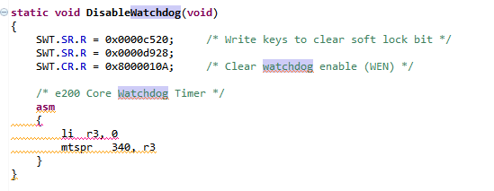

I am using S32DS to create a function combined by C and assembler language which is copied from your official net. This project is used in MPC5643L. But it has a problem when I tried to build the project. I wonder if there are problems in my setting or format, etc. Could you give me a demo about how to create a function combined by C and assembler language?

Inline assembly syntax can be slightly different for compilers.
In case you use GCC syntax is described there Using the GNU Compiler Collection (GCC): Extended Asm
