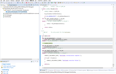

aiweixin
Hi Gary,

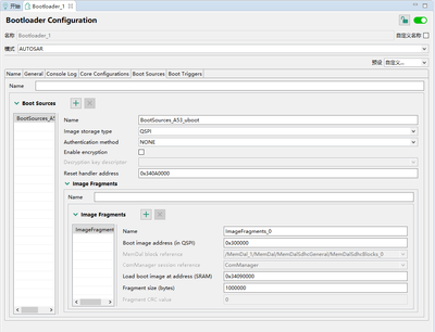

    I have tried to do it as following these steps:

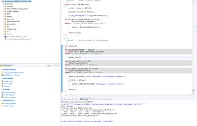

    1) import the bootloader integration example on S32DS, and open the .mex file to generate code;
    2) build it successfully.

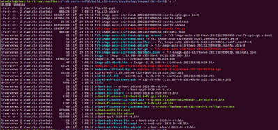

    3) build the linux, and generate linux files(uboot, image, dts, rootfs);

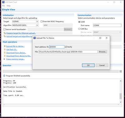

    4) use s32ft.exe to upload uboot to flash(the address is same as BootSources_A53_uboot in step 1);

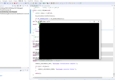

    5)  debug bootloader project by S32 Debug Probe.
    But, there is nothing output on the COM (Serial port).
    where do i make some mistakes?
