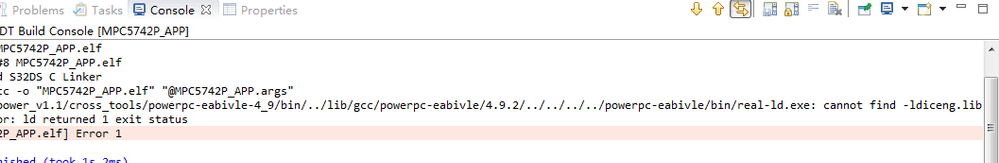

I creat a lib file with S32DS in this way: file->new->new s32ds project->library project ,and in this file , I creat a simple function to test that if it is ok .
Then I creat a elf project file,and add the lib file "libdiceng.a" into the elf project's workspace ,like below.
but it Prompt compilation error
I don't konw how to do this exactly ,thankyou.

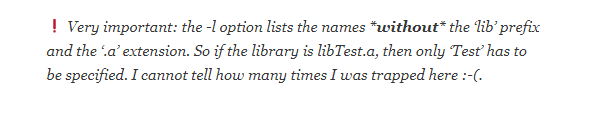

Hi Suomi,
the library name needs to be lib<name>.a, but in the linker you only specify the name (without lib and .a).
See Creating and using Libraries with ARM gcc and Eclipse | MCU on Eclipse
or How to use Custom Library Names with GNU Linker and Eclipse | MCU on Eclipse
I hope this helps,
Erich

jeffqin
BlackNight‌ Thanks, I have checked it, it does not have this beginning.
7,065 Views
BlackNight
Hi Jeff,
in that case, it is not a library.
Erich

suomichen
 Hi Erich,
Thankyou so much !!
the last words help me a lot
best regards
