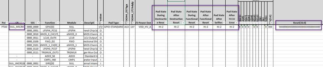

You didn't specify the MCU series, I assume it is S32K3xx.
The default state of the pins out of reset is Hi-Z, there is no need to initialize those pins.
Refer to the IOMUX.xlsx attached to the RM.
There is the reset state of the MSCR registers, MSCR[MUX = OBE = IBE = PUE = 0] which disables the output buffer, input buffer, and pull device.
