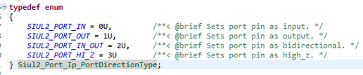

How can I configure a port pin as Hi-Z state in S32DS?
I'd appreciate it if you could show me an example.
Thanks.

The Configuration tool does not allow to dissable the buffers.
Even the No init sets the buffers as per the initial direction configured there.
But the pins can be configured for SIUL2 (which is the default muxing) and set them to inputs since the GPIO inputs have high impedance.
After the initialization, the pins can be set to Hi-Z using the Siul2_Port_Ip_SetPinDirection() if you want to have the input buffer disabled too.

Thanks for you reply. And yes, I'm using S32K312.
My problem is that I need some pins to stay Hi-Z, and other pins to be initialized as output/input before my task starts running (I'm using FreeRTOS).
And after my task starts running, I want to set directions for the pins staying Hi-Z state just now by using this API Siul2_Port_Ip_SetPinDirection. If I do not initialize them, then I cannot use the API to set their directions later.
In other word, I do not want those pins to always keep Hi-Z. I only want them to keep Hi-Z at the beginning and I need to configure them as GPO at sometime when my code is running. Any suggestions about it?
